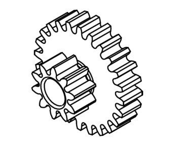

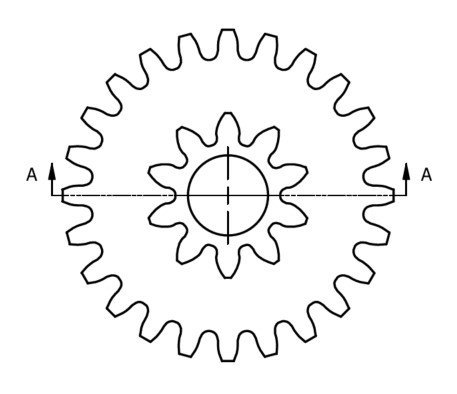

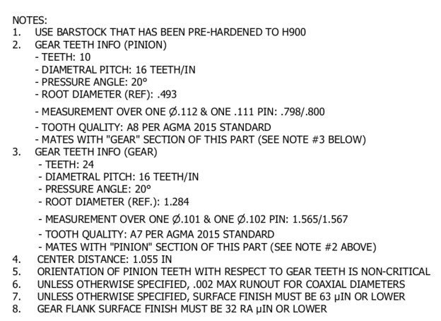

[To...] Posted September 10, 2025 Share Posted September 10, 2025 Is there any reason why this part can't be checked with a single down stylus? The major dia. of top gear is Ø.755" and the lower gear is Ø1.555" Does the letter "A" in the tooth quality mean anything. It appears GearPro only shows a number. Thanks in advance. Link to comment Share on other sites More sharing options...

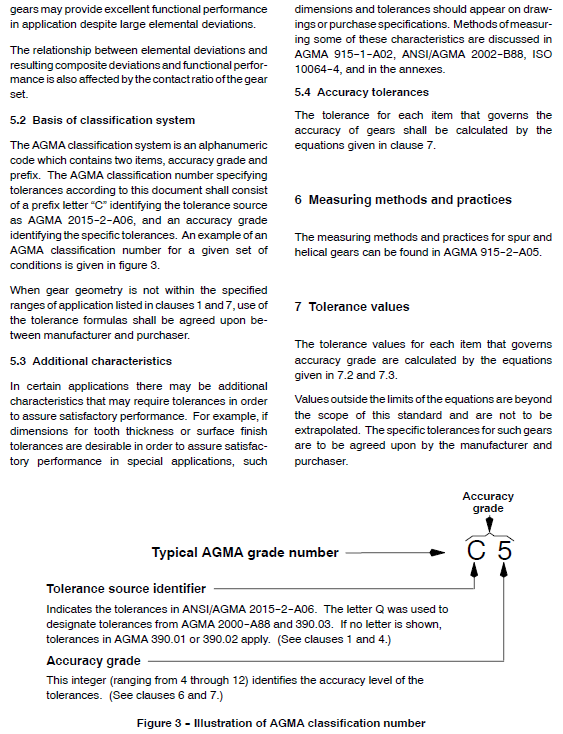

[Ch...] Posted September 10, 2025 Share Posted September 10, 2025 (edited) Tom, no reason, just be careful of shanking for profile and if there were any lead crowning etc. "A" refers to the spec, they're kind of broken up into 2, one for analytical, one for composite roll testing. Good thing is just choose AGMA 2015 and class # in Gear Pro and it will take care of the tolerance. Edited September 10, 2025 1 Link to comment Share on other sites More sharing options...
