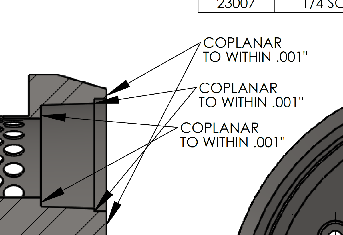

[Al...] Posted September 10, 2025 Share Posted September 10, 2025 Hoping someone can help me with this since I'm new to programming in Calypso! How do you measure this? Link to comment Share on other sites More sharing options...
[Ma...] Posted September 10, 2025 Share Posted September 10, 2025 This should be parallelism between each other - if it's meant for those 3 planes and not as some additional info to some callout. 2 Link to comment Share on other sites More sharing options...
[Ri...] Posted September 10, 2025 Share Posted September 10, 2025 I would think Surface Profile with a Common Zone would be more appropriate. 1 Link to comment Share on other sites More sharing options...
[Cl...] Posted September 10, 2025 Share Posted September 10, 2025 Ditto to Richards recomendation. Also, If you have a model you can use space points on each of the surfaces. this will give you the plus/minus material condition for each surface. 1 Link to comment Share on other sites More sharing options...
