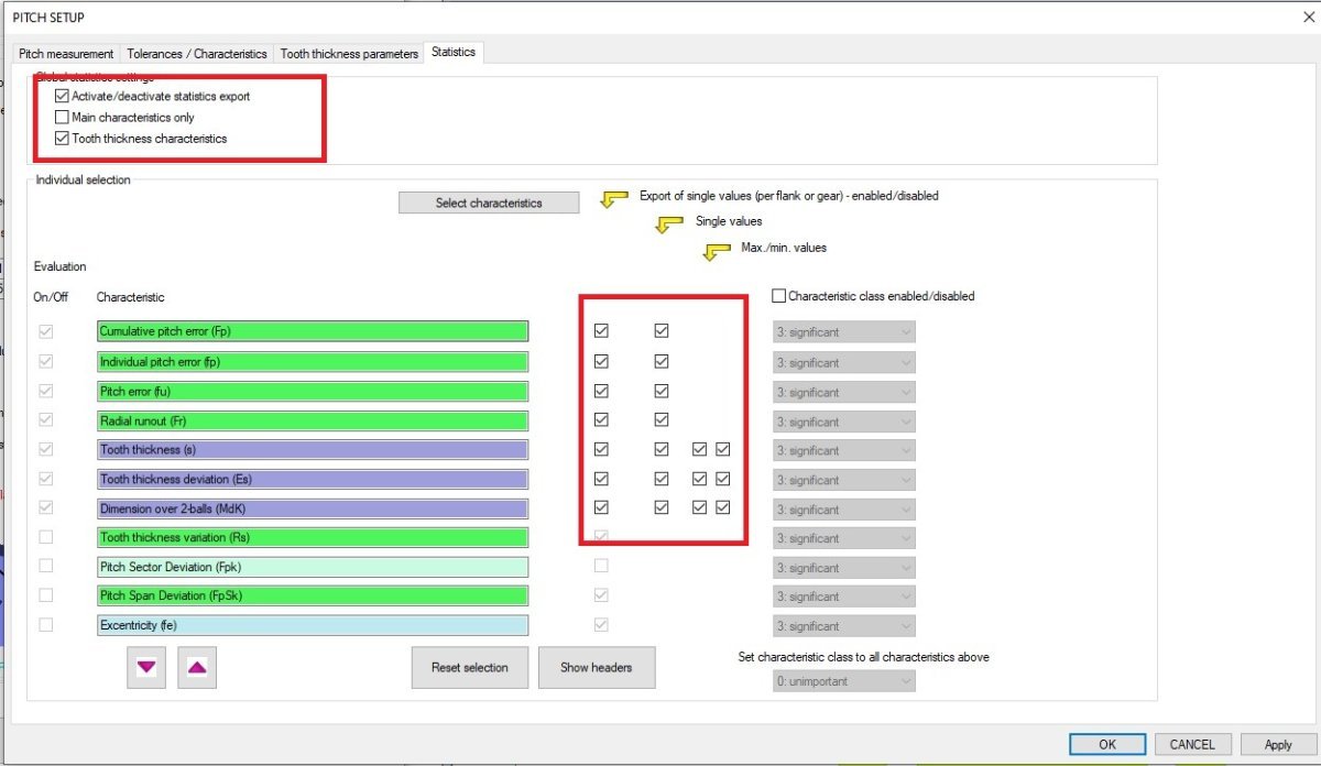

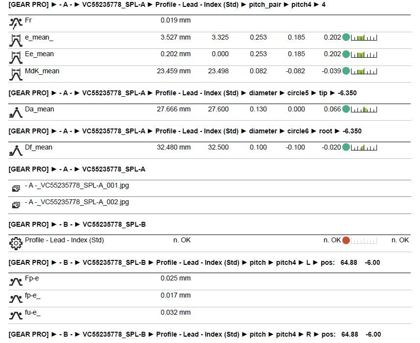

[Ed...] Posted September 11, 2025 Share Posted September 11, 2025 Hi, I need to get GearPro results into PiWeb for statistics. It looks like I could achieve something, but not fully. 1. Is it possible to get also min/max results for "e", "Mdk", "Da" and "Df" like in GearPro printout? 2. Why -A-_VC55235778_SPL-A_001.jpg doesn`t show anything? In Piweb also shows that it doesn`t exist? Thanks 🙂 Link to comment Share on other sites More sharing options...
[Ed...] Posted September 11, 2025 Author Share Posted September 11, 2025 Hi again, Found the answer for the first question, if somebody would ever need it. 2 1 Link to comment Share on other sites More sharing options...
[Do...] Posted November 17, 2025 Share Posted November 17, 2025 Hello Mr. Putelis, we need to analyse the second question in more detail. I would ask you to call your local customer interaction center hotline and request a ticket. Link to comment Share on other sites More sharing options...
