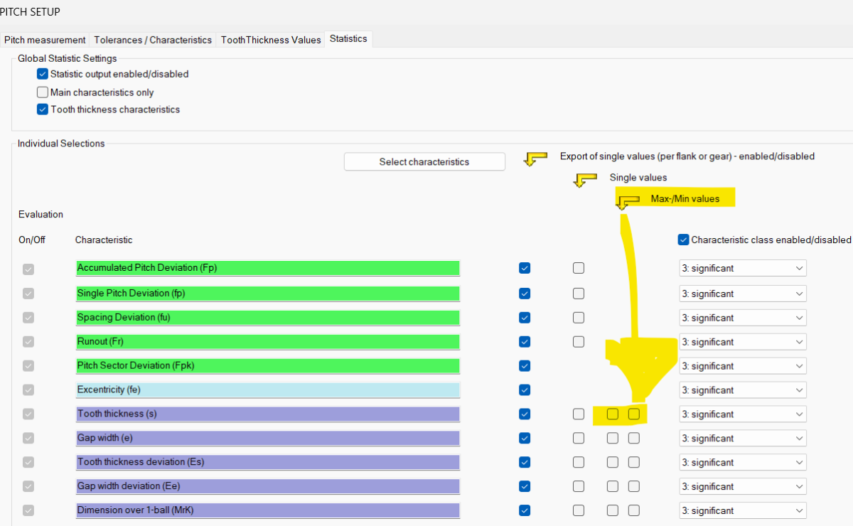

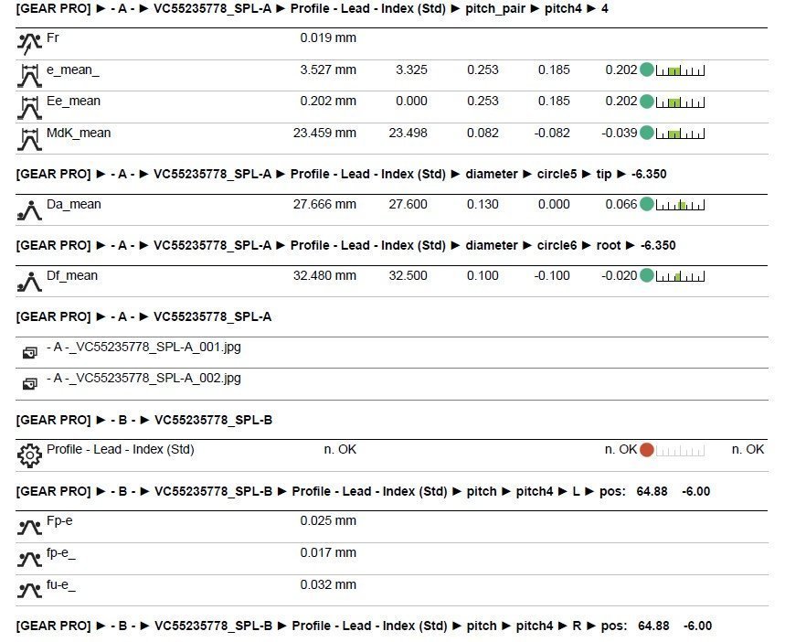

[Ed...] Posted Thursday at 11:34 AM Share Posted Thursday at 11:34 AM Hi, I need to get GearPro results into PiWeb for statistics. It looks like I could achieve something, but not fully. 1. Is it possible to get also min/max results for "e", "Mdk", "Da" and "Df" like in GearPro printout? 2. Why -A -_VC55235778_SPL-A_001.jpg doesn`t show anything? In Piweb also shows that it doesn`t exist? Thanks 🙂 Link to comment Share on other sites More sharing options...
[Ed...] Posted Thursday at 01:11 PM Author Share Posted Thursday at 01:11 PM Hi again, Found the answer for the first question, if somebody would ever need it. Link to comment Share on other sites More sharing options...

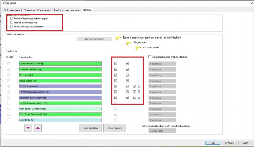

[Ro...] Posted Thursday at 01:28 PM Share Posted Thursday at 01:28 PM Hi, regarding #1 You have to activate the export of those values ... Regarding #2, have a look into the manual of GEAR PRO and search for "PiWeb". If you want to see the GEAR PRO pages in PiWeb you have to activate this in the ptx of PiWeb: " ... To ensure that the attached individual GEAR PRO report pages automatically appear in A4 portrait in the PiWeb report, a page hidden by default was added to the CALYPSO default PiWebReportingTemplate (StandardProtocol.ptx) in CALYPSO 2018. The page is called Picture view and can be activated in the PiWeb Designer for this StandardProtocol.ptx file, if necessary. Once this page has been activated, all images found in the dataForPiWebReporting folder within a CALYPSO measurement plan will be automatically attached to the CALYPSO standard report on a separate A4 portrait page upon completion of the CNC run. ..." 1 1 Link to comment Share on other sites More sharing options...
