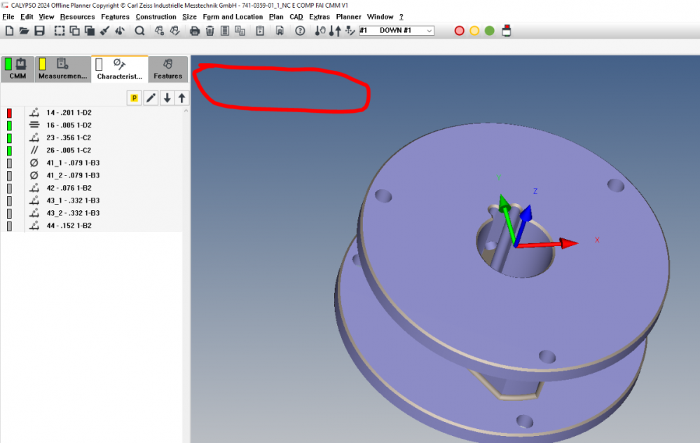

[Jo...] Posted September 12, 2025 Share Posted September 12, 2025 Hi all, I was wondering if anyone knew how to add text to the CAD window in CALYPSO. Just like a simple instruction that is always displayed in a certain area in the CAD window (see image). I've seen it in CMM programs in CALYPSO before, but I've never done it myself. Thanks!! Link to comment Share on other sites More sharing options...
[Ow...] Posted September 12, 2025 Share Posted September 12, 2025 Go to Cad and select "cad model control" and then at the bottom of the menu, select comment. 4 Link to comment Share on other sites More sharing options...

[Ri...] Posted September 12, 2025 Share Posted September 12, 2025 I use what Owen described all the time, it lets me and or operator know if the model is up to date or for "Visual Only". Up to date model: Color GREEN Part No. and Rev level. Out of date, or visual only: Color RED "Visual Only" 1 Link to comment Share on other sites More sharing options...
[Da...] Posted September 12, 2025 Share Posted September 12, 2025 We put loading info on there , saves a lot of our greener operators from crashing an upside down part!😀 1 Link to comment Share on other sites More sharing options...

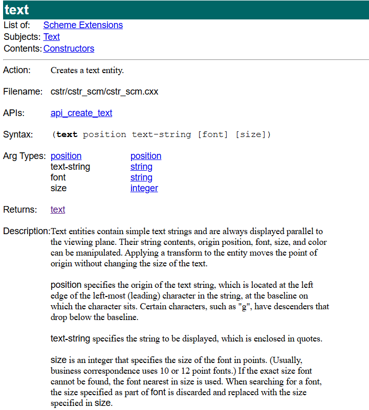

[Ch...] Posted September 17, 2025 Share Posted September 17, 2025 I think I know 'how' to do it. Would require executeCode() and sending messages to the Acis window, which I've done, however the syntax gets a bit trick due to ' "quotes" ' Would be much easier for Zeiss. 2 1 Link to comment Share on other sites More sharing options...

[Ch...] Posted September 22, 2025 Share Posted September 22, 2025 Just some of the code that writes to the CAD window (Acis). From what I can tell they did not add into their code the option to change the font etc which is a normal function of the acis code as per above. Link to comment Share on other sites More sharing options...

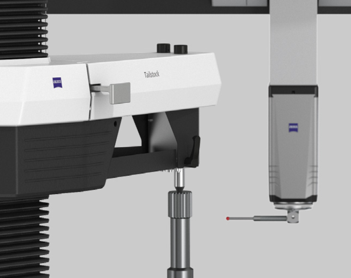

[Ch...] Posted September 23, 2025 Share Posted September 23, 2025 my belly is not actually that big, they just fed me well, I actually lost even more weight after fasting. but yeah you found me, with a couple brilliant Zeiss guys picking up the 1st Zeiss T/S for USA and my company Moog Aircraft. Pretty versatile piece of equipment. Wenzel is now offering something similar as well. 3 Link to comment Share on other sites More sharing options...
[Ro...] Posted September 23, 2025 Share Posted September 23, 2025 Please sign in to view this username. That's Murtaza on the right! Great guy. 2 Link to comment Share on other sites More sharing options...
[Je...] Posted September 24, 2025 Share Posted September 24, 2025 Please sign in to view this username. Outstanding! That must have been a memorable trip. I've seen that T/S device in marketing images, but I don't know much about it. Is the top connecting point always a tapered center? Interested to hear your thoughts after getting some miles in on it, per what you're allowed to share. P.S. I've inspected plenty of Moog components upstream. Historic company. I remember being impressed by the quality of their drawings. Link to comment Share on other sites More sharing options...
[Ch...] Posted September 24, 2025 Share Posted September 24, 2025 Jeff, Yes usually a tapered center, however anything can be adapted via a standard Morse taper. Same high accuracy, precision and quality of Zeiss , coupled with a new 5th axis to inspect part families. We got it to back up 2 machines, so kind of 2 for 1 deal. Link to comment Share on other sites More sharing options...

[No...] Posted September 24, 2025 Share Posted September 24, 2025 Please sign in to view this quote. You know that you can enter all that Scheme Extensions stuff directly in the ACIS window for test purposes. Here's a somewhat outdated but still very useful resource: http://www-isl.ece.arizona.edu/ACIS-docs/ Click "List of..." then select "Scheme Extrensions" 3 Link to comment Share on other sites More sharing options...
