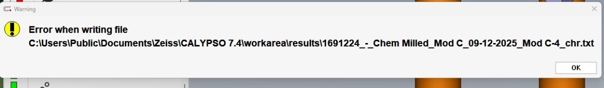

[Ri...] Posted September 13, 2025 Author Share Posted September 13, 2025 On all three of our v2022 installs we randomly get the following error message. I can't think of any setting that could interfere with creating a text file on a local drive. Link to comment Share on other sites More sharing options...
[Ma...] Posted September 13, 2025 Share Posted September 13, 2025 Only thing what i can think of is low free space or third party antivirus. Is it randomly not working or just that message but files are not created even without message? Link to comment Share on other sites More sharing options...
[Ri...] Posted September 15, 2025 Author Share Posted September 15, 2025 It is random, most times it is the characteristic file, other times it can be more than one file not being created. When file creation fails, it is always followed by the error message. Link to comment Share on other sites More sharing options...
