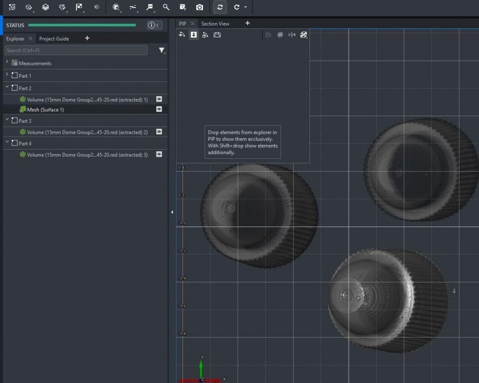

[Br...] Posted September 17 Share Posted September 17 Is there a way to polygonize multiple volumes after extracting, after import and separate? I have been performing this task one-at-a-time, and it seems there would be a way to automate this process. Link to comment Share on other sites More sharing options...
[DW...] Posted September 24 Share Posted September 24 Please sign in to view this username. You can record your actions with the built in Python editor and then tweak. Have you ever used the editor to script before? Link to comment Share on other sites More sharing options...
[Br...] Posted September 25 Author Share Posted September 25 I have not found time to give the Python editor the time needed to get this under my feet. Link to comment Share on other sites More sharing options...
[DW...] Posted September 25 Share Posted September 25 Please sign in to view this quote. Please sign in to view this username. Can you elaborate on the process you are trying to automate? Like the exact workflow? Link to comment Share on other sites More sharing options...
[Br...] Posted September 26 Author Share Posted September 26 Typical process would be: import multi-sample scan Reduce Vol Size extract vol areas automatically polygonize each of the separated volumes select each mesh individually (except for first) "copy selected points" and drag copied below in explorer window, add as stage to first ("Part1") Link to comment Share on other sites More sharing options...
[Ti...] Posted September 26 Share Posted September 26 Looks like you have 1 volume, with 3 parts. Polygonize them all at once. Then separate each mesh. Link to comment Share on other sites More sharing options...
[Br...] Posted September 26 Author Share Posted September 26 I was unaware you could do that! That will help, would still like to end up with automated process for all steps, but this is extremely helpful 🙂 Thanks! Link to comment Share on other sites More sharing options...
[Ti...] Posted September 26 Share Posted September 26 Open the python editor once you have the volume loaded. Record. Then polygonize the use the picker tool to box off the first mesh, invert, ctrl-delete, export mesh. Save box coordinates in a excel file. Learn to code in python and loop thru all coordinates. Link to comment Share on other sites More sharing options...
