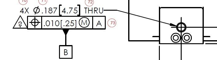

[Ja...] Posted September 17, 2025 Share Posted September 17, 2025 We have a part with 4 holes and below the FCF, Datum B is linked. Does this mean all 4 holes create Datum B or just the hole the drawing is point to? See pic below Link to comment Share on other sites More sharing options...
[Ma...] Posted September 17, 2025 Share Posted September 17, 2025 This should be pattern of 4 holes as datum B with activated MMC 2 Link to comment Share on other sites More sharing options...
[Ja...] Posted September 19, 2025 Author Share Posted September 19, 2025 Thats what I thought, I appreciate the response Link to comment Share on other sites More sharing options...

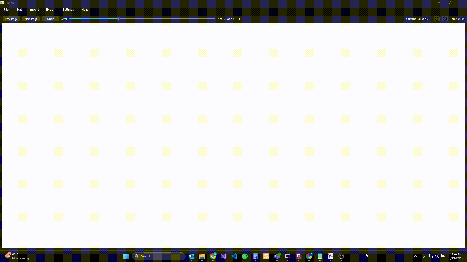

[DW...] Posted September 19, 2025 Share Posted September 19, 2025 Please sign in to view this quote. Please sign in to view this username. Martin is right. Completely unrelated, you might want to check out Hollow Circle Numbering from pdfautomationstation. I think its like $20 every 2 years for their bubble utility. It adds a very clean look when numbering a drawing. Link to comment Share on other sites More sharing options...
[Ri...] Posted September 19, 2025 Share Posted September 19, 2025 (edited) Please sign in to view this username. or just make your own. 🙂 Edited September 19, 2025 1 Link to comment Share on other sites More sharing options...
[DW...] Posted September 19, 2025 Share Posted September 19, 2025 Please sign in to view this quote. Please sign in to view this username. Well done sir. I may look into it if I have some time in the future. 1 Link to comment Share on other sites More sharing options...
[Ri...] Posted September 19, 2025 Share Posted September 19, 2025 Thank you. It does take some time. I'm still learning a lot, but this program was a lot of fun to create. I'm slowly implementing my own OCR to be able to create AS9102/PPAP forms automatically. Still a long way to go on the OCR side of things, but it's a fun journey. Link to comment Share on other sites More sharing options...
