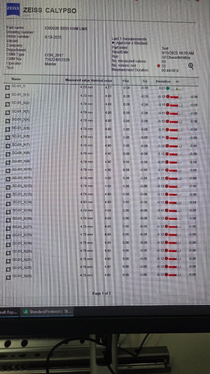

[To...] Posted Friday at 03:15 PM Share Posted Friday at 03:15 PM I feel like I am missing something obvious here, but when I pattern features and dimension from those features only the first dimension has the correct nominal. What am I missing? Link to comment Share on other sites More sharing options...
[Ma...] Posted Saturday at 09:12 PM Share Posted Saturday at 09:12 PM Under a feature choose Nominal Geometry pull down menu and choose Pattern. Select the pattern method. Define the pattern location and amount of holes, or features within a pattern. This will define the nominals for you. Link to comment Share on other sites More sharing options...

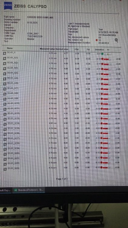

[To...] Posted Monday at 05:58 PM Author Share Posted Monday at 05:58 PM I already have the pattern created the issue I am having is on the reporting side where only the first dimension in the pattern has the correct nominal. I have attached a picture of the report. Link to comment Share on other sites More sharing options...
[Wo...] Posted 3 hours ago Share Posted 3 hours ago You probably have a different nominal in the feature. If you have 4.90 nominal in the feature, and then change it to4.77 in the characteristic nominal - it will only get changed in the first result, the rest will take nominal from the feature (4.90). You can either correct the nominal in the feature, or right click the nominal in the characteristic, choose "formula" and write 4.77 there. Then 4.77 will get applied to all results. Link to comment Share on other sites More sharing options...
