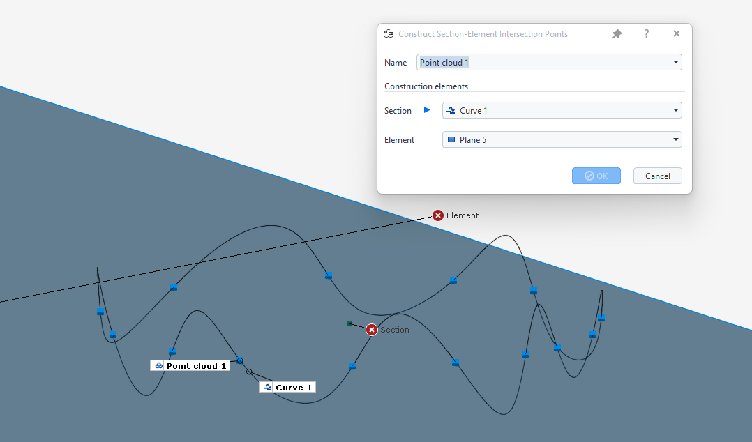

[Aj...] Posted September 24, 2025 Share Posted September 24, 2025 Hello everyone, I am trying to automate a measurement process on a prismatic part. I have a curve which runs around the circumference of the whole part. I want to first cut this curve with a plane. With the resulting intersection points I want to construct a circle. I have carried out this process and recorded it, and the script works. The problem that I have is that the points (probably around 200) appear in the measurement plan, in the explorer. Is it possible that the process of intersection points takes place in the background, without creation of the elements, so that only the circle gets created as an element and is available in the explorer? Every time I create a resulting element I have to go through a number of construction steps. The idea is that the construction steps take place in the background (in the code), so that only the resulting element which is used for further measurement is available to be measured. Thanks, Ajay Link to comment Share on other sites More sharing options...

[Na...] Posted September 30, 2025 Share Posted September 30, 2025 Hi, maybe a point cloud from Section-Element Intersection Points (https://techguide.zeiss.com/en/zeiss-inspect-2025/article/cmd_pointcloud_create_by_intersecting_section_element.html) works for you? The intersection points result in one element and can be used as the selection for fitting elements. Nanno Link to comment Share on other sites More sharing options...
