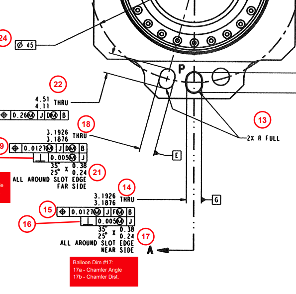

[He...] Posted September 25, 2025 Share Posted September 25, 2025 (edited) Hello gentlemen, I'm creating the program and I'm struggling with MMC position call out on the slot. Could you guys please help me with that? Edited September 25, 2025 The print was not clear Link to comment Share on other sites More sharing options...
[Cl...] Posted September 25, 2025 Share Posted September 25, 2025 Depending on the thickness of the material there. You can measure two planes on the slots opposing sidewalls and construct a symmetry plane from them. This recalls all the points from each to create the symmetry plane which can then be used to apply the MMC. Link to comment Share on other sites More sharing options...
[Ri...] Posted September 25, 2025 Share Posted September 25, 2025 Use a slot feature (If the feature is too thin), this can be done as a 2D feature and still apply modifiers. From the from down menus. Features: Special Geometries: Slot. Link to comment Share on other sites More sharing options...
[He...] Posted September 25, 2025 Author Share Posted September 25, 2025 I did that but no giving me the MMC option Link to comment Share on other sites More sharing options...

[Ma...] Posted September 25, 2025 Share Posted September 25, 2025 Please sign in to view this quote. Are you sure you did a symmetry plane? MMC can not be placed on ordinary symmetry OF planes. You would need to recall measured points into symmetry plane. Link to comment Share on other sites More sharing options...
[Ke...] Posted September 25, 2025 Share Posted September 25, 2025 FYI: Symmetry - Is in the "Construction" drop-down Symmetry Plane (which you need) is in the "Feature" drop-down, under "Special Geometries" 1 Link to comment Share on other sites More sharing options...
[He...] Posted September 25, 2025 Author Share Posted September 25, 2025 Please sign in to view this quote. Yes, I did. I created 2 planes across and I reconducted those 2 planes as symmetry plane but the only issue it did not give me the MMC Option. Link to comment Share on other sites More sharing options...
[Cl...] Posted September 25, 2025 Share Posted September 25, 2025 Features >Special Geometries > Symmetry Plane > Options > Recall Feature Points? Link to comment Share on other sites More sharing options...
[Ed...] Posted September 26, 2025 Share Posted September 26, 2025 Hi, Check this one! True_Position_of_Slot_with_MMC.pdf 1 1 Link to comment Share on other sites More sharing options...
[He...] Posted September 26, 2025 Author Share Posted September 26, 2025 Please sign in to view this quote. Yes sir. Link to comment Share on other sites More sharing options...
[Ma...] Posted September 26, 2025 Share Posted September 26, 2025 (edited) Please sign in to view this quote. In the true position, ensure to switch it to a single direction only(X only or Y only) instead of the diametric. Then, the MMC option should appear. If that doesn't work, then for tolerance use a formula (getActual("Symmetry Plane1").distance-3.1876)+0.0127 Edited September 26, 2025 Link to comment Share on other sites More sharing options...
