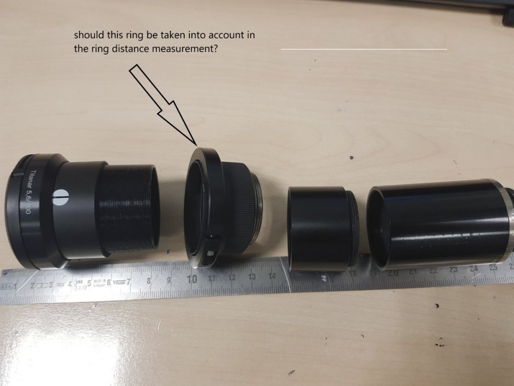

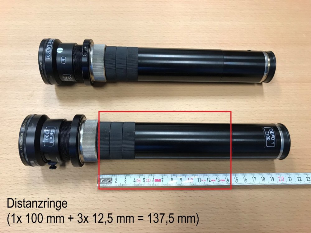

[Iv...] Posted June 18, 2021 Share Posted June 18, 2021 Hi Sébastien, please check those Images. The Lense itself on your image is the first two parts and the last one. Anything else is the additional distance ring. Greetings, Ivan Link to comment Share on other sites More sharing options...
