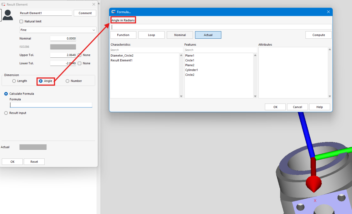

[Da...] Posted September 30, 2025 Share Posted September 30, 2025 OK, I have to relearn how to program in Calypso. I had programs written and used in <V2016, but now have to rewrite them in 2025. We lost a bunch of data with no chance to recover. Anyway, the project today I am redoing I need to get the opposite side of a cone's half angle. It is a 150 degree cone, so I divide that by half to get 75, then subtract that from 90 to get the 15 degree that is called out. So far, the formulas I have found are not working, at least not pulling the correct nominal. Do I need to actually get a part measured to see if these work? Link to comment Share on other sites More sharing options...

[Ky...] Posted September 30, 2025 Share Posted September 30, 2025 How far off are we talking? If it looks like utter nonsense, you might be putting the formula in degrees when it is expecting to be in radians: Note that it automatically converts that value to whatever units you are in, so you don't need to convert the result back into degrees. Link to comment Share on other sites More sharing options...
[Da...] Posted September 30, 2025 Author Share Posted September 30, 2025 From what I can see, I can only work in radians in the result element. That is why I was using a formula to convert this into degrees. I had not yet actually measured a part, but when I 'testing' the formula, it was giving me some very unrealistic results. As it turns out, the testing, and ultimately the actual result, only works when you have actual data. Once I actually measured the part, the formula I found (rad(90)- getActual("Half Cone Angle1").actual) does work. Link to comment Share on other sites More sharing options...
[Ma...] Posted September 30, 2025 Share Posted September 30, 2025 In previous versions, I have had to convert from radians to degrees, then apply the rest of the formula. Its been a very long time since I had to do that in results element, so I have no idea how the new versions work. Link to comment Share on other sites More sharing options...
