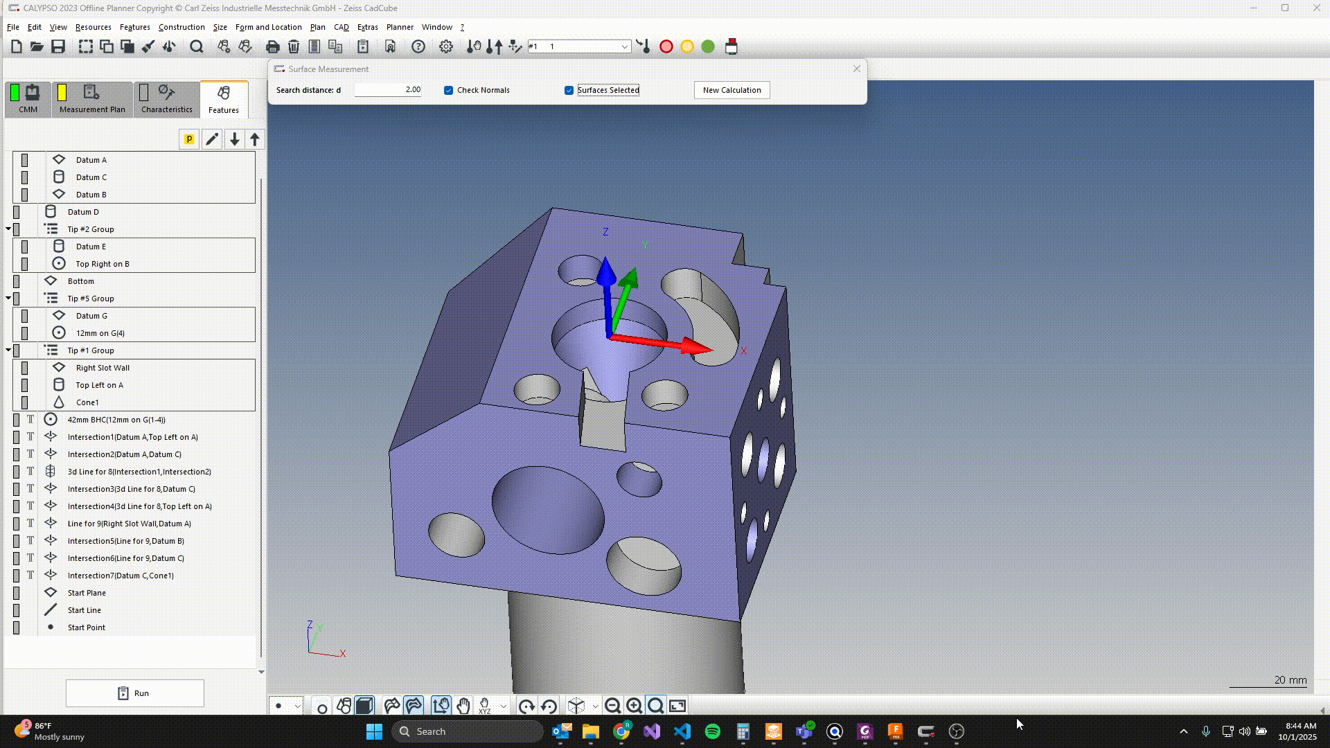

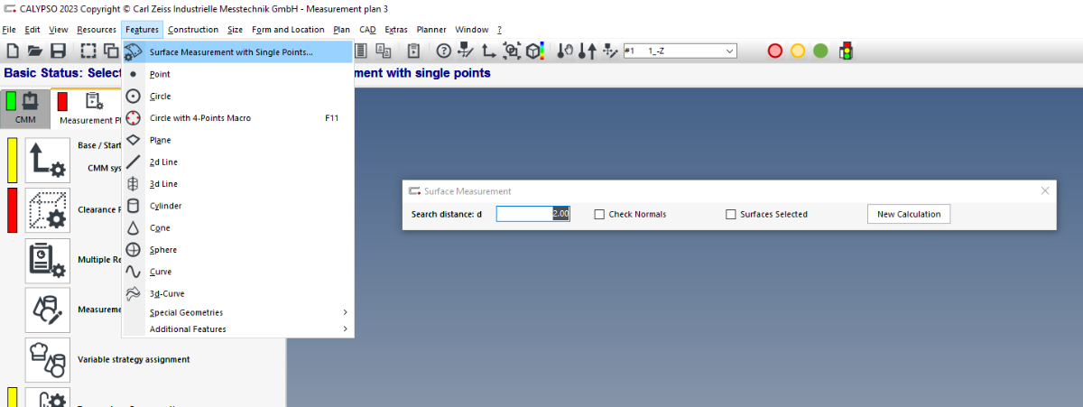

[To...] Posted October 1, 2025 Share Posted October 1, 2025 (edited) Does anyone know what this is or how it is intended to be used. Edited October 1, 2025 Link to comment Share on other sites More sharing options...
[Ri...] Posted October 1, 2025 Share Posted October 1, 2025 I believe this replaced the General Surface that could be used. Link to comment Share on other sites More sharing options...

[To...] Posted October 1, 2025 Author Share Posted October 1, 2025 Please sign in to view this quote. I've heard of General Surface but have no clue why or where I would use one. I guess that will be the next topic in my new series entitled "What is it?" Link to comment Share on other sites More sharing options...
[Ri...] Posted October 1, 2025 Share Posted October 1, 2025 I believe the General Surface was used for people who didn't have Free-Form. I had never personally used it. Regarding the Surface Measurement with Single Points - it would just be the best way for a person to easily do a Profile deviation as it automatically will drop in the Space Point Distance - but having said that, I wouldn't use Space Points if it is a non-normal surface. Link to comment Share on other sites More sharing options...
