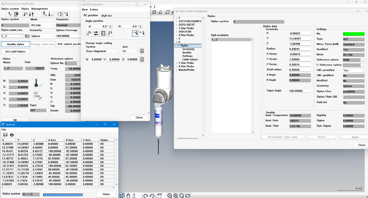

[Pe...] Posted October 2, 2025 Share Posted October 2, 2025 Found a mildly infuriating problem. Running simulation and all the sudden all my RDS probes acquired odd values in the X, Y and Z positions. It started visually showing the stylus and head something like 6 inches off the part, but still gives good nominal feature values after simulation. I try to requalify my probe. First, it says that I cant do it because its going to shank out on the reference sphere or its at the wrong angle. Wierd because Ive been simulating the same probe for years. So I grab the master probe, set the reference sphere location, then try again and it works. But now I have completely different XYZ values that dont make any sense. I hit requalify again, it does its 12 angles, and then a completely different result: Same probe 3 times in a row. Not entirely arbitrary because 5.232 seems to be repeating in various places. Any thoughts? Link to comment Share on other sites More sharing options...
[Ri...] Posted October 2, 2025 Share Posted October 2, 2025 Show screen shots of the stylus geometry from the Stylus Management dialog box for each stylus. Link to comment Share on other sites More sharing options...
[Pe...] Posted October 2, 2025 Author Share Posted October 2, 2025 (edited) Please sign in to view this quote. I think I got just about everything relevent in there. If I hit the qualify stylus button, then all the numbers change. Edit: I do have a work around for now. If I delete all the rds systems from the management, and reimport the ssc file, the fresh probe work. But if I hit the qualify then the problem comes back. Also it didnt affect any of the fixed 5 point stars, only rds probes. Edited October 2, 2025 Link to comment Share on other sites More sharing options...

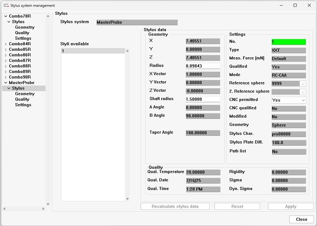

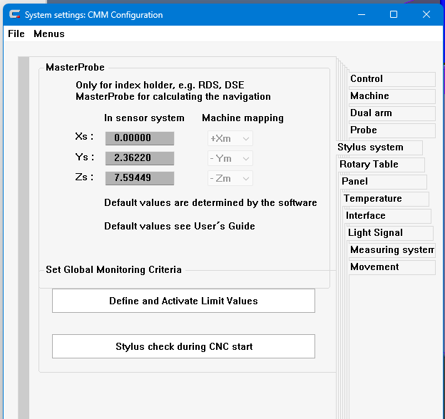

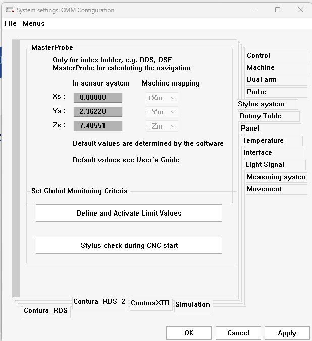

[Ri...] Posted October 3, 2025 Share Posted October 3, 2025 What does your RDSCAA MasterProbe information show? This is mine for a standard RDSCAA MasterProbe and TL3 Sensor. Also shown is my MasterProbe after qualification for Planner. Link to comment Share on other sites More sharing options...

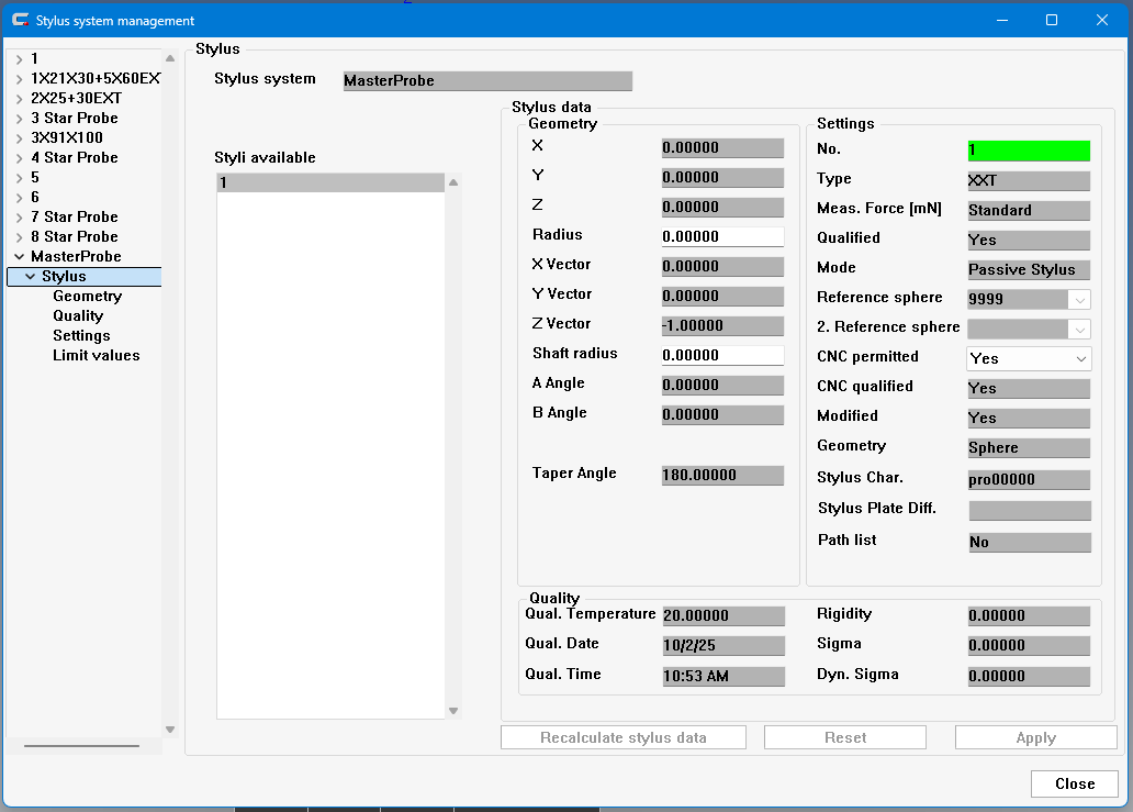

[Pe...] Posted October 3, 2025 Author Share Posted October 3, 2025 Please sign in to view this quote. Looks pretty simular to yours. The master probe I use looks a bit different since it is not qualified as an RDSCAA. I wasnt actually aware that you could do that even - Is there a reason/benefit to it? Link to comment Share on other sites More sharing options...
[Ri...] Posted October 3, 2025 Share Posted October 3, 2025 I do not know if there is a benefit. When I imported it, I selected RDS CAA. What I do notice is your X and Z are both 0.0000. Link to comment Share on other sites More sharing options...
