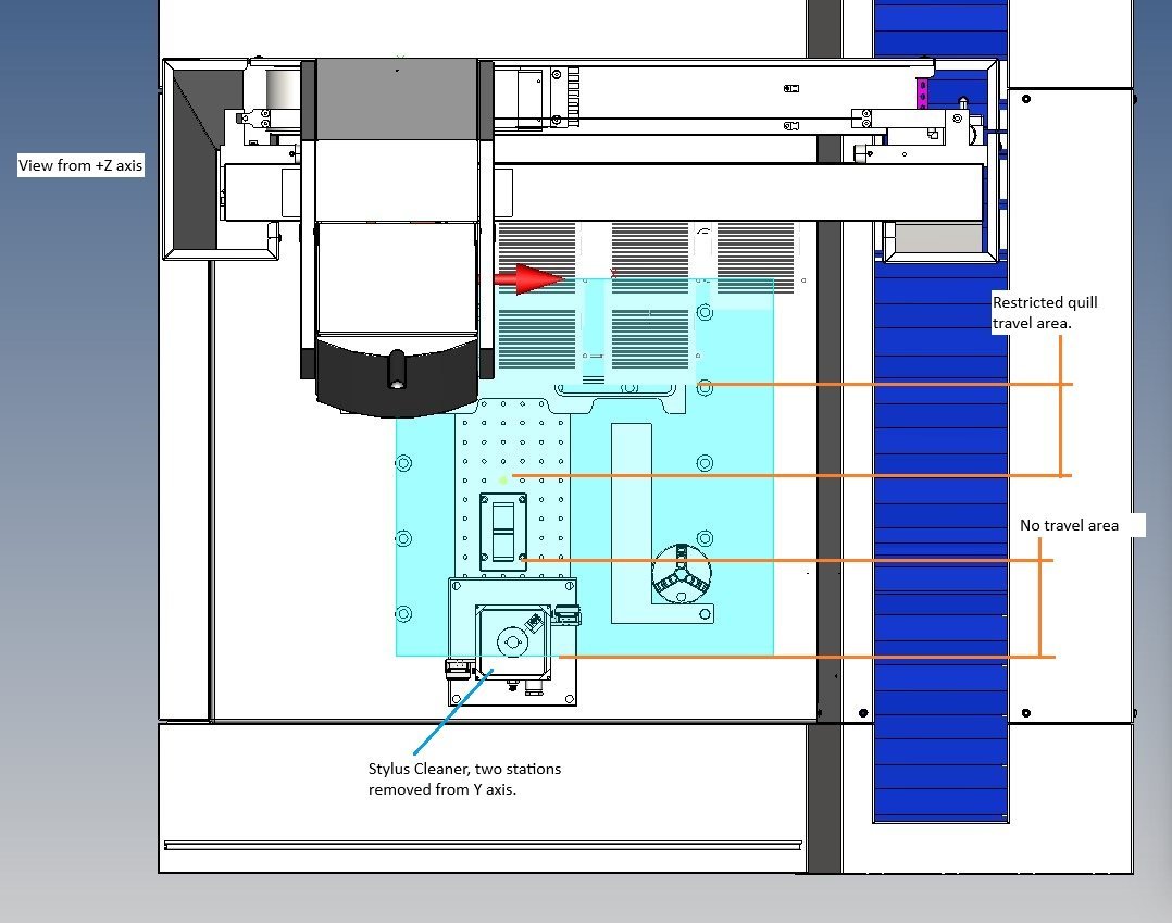

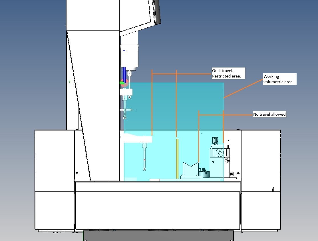

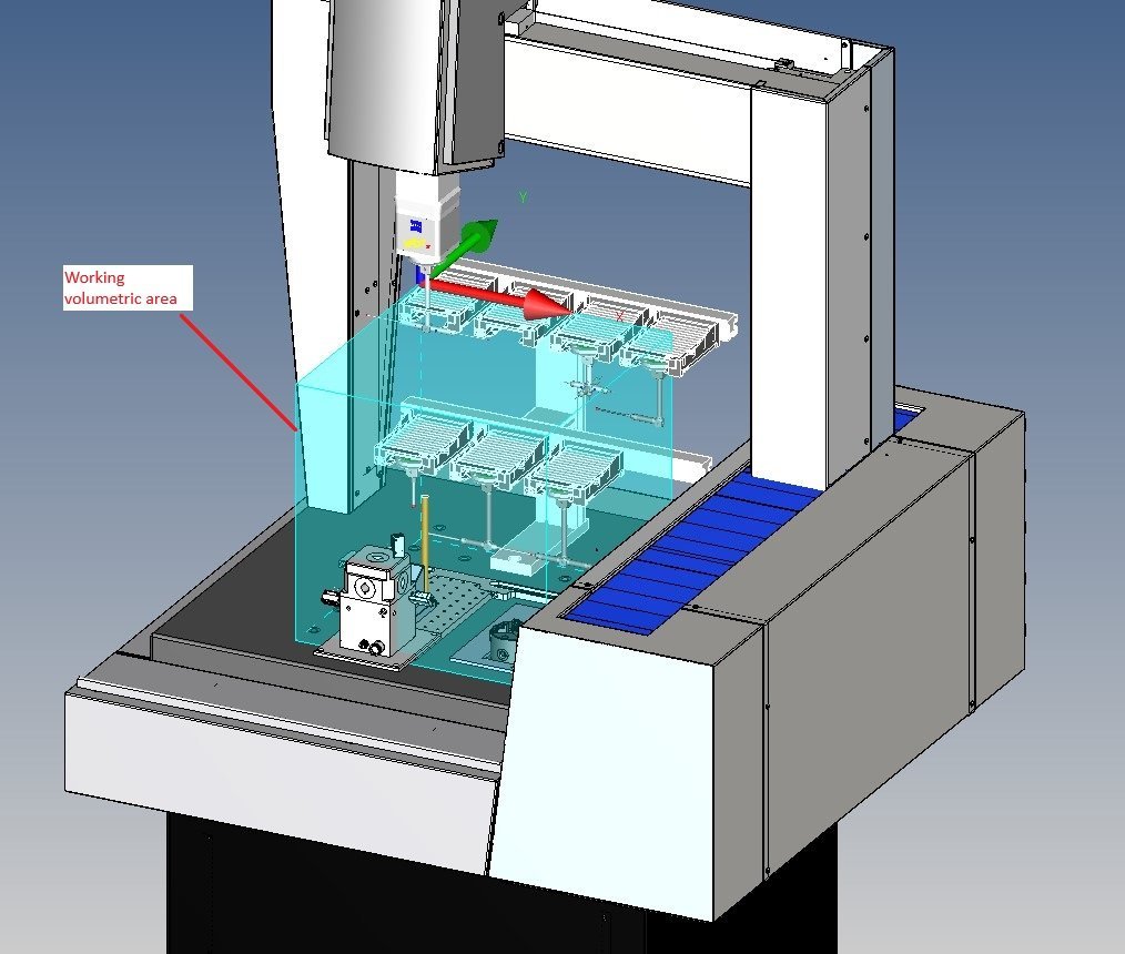

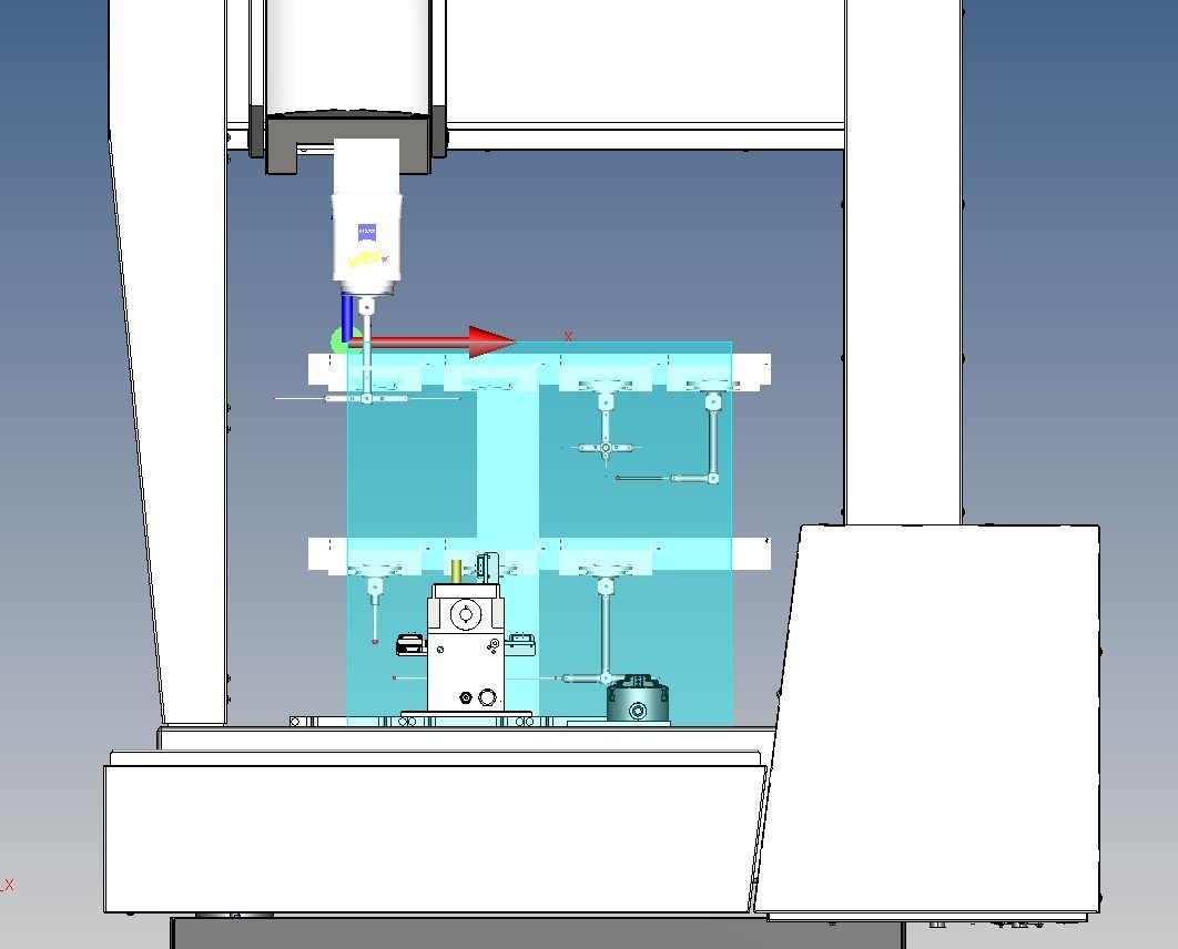

[Ri...] Posted October 2 Share Posted October 2 I am trying to fit a Stylus Cleaner on a Micura with a minimal working area. What I am having trouble doing is obtaining the maximum travel in my Y axis, both negative and positive travel from a fixed center line. The center Line would be from the StyliCleaner BV unit shown in the model. The goal is to figure out if I have the travel area to approach the StyliCleaner from either side of the Y axis with probes that require long extensions and styli, do I have enough room to travel to and from. Some might recall my post of forcing probe travel to be only in the Z axis, this is part of the planning too. Basically, reaching out to Zeiss engineers who most likely know travel limits that could help me out. In the next post is a model in 7z format. Any help is appreciated. 3x50_318015851.ssc 1 Link to comment Share on other sites More sharing options...

[Je...] Posted October 16 Share Posted October 16 Limits are controller based and not readily accessible to the user. They also may be re-set or adjusted when a service tech remaps the machine during calibrations. 1 Link to comment Share on other sites More sharing options...
[Ri...] Posted October 17 Author Share Posted October 17 Thank you, Jeffrey. I will have to place my fixture within the current end limit of at least .50" and hope it never over travels. Link to comment Share on other sites More sharing options...
