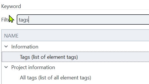

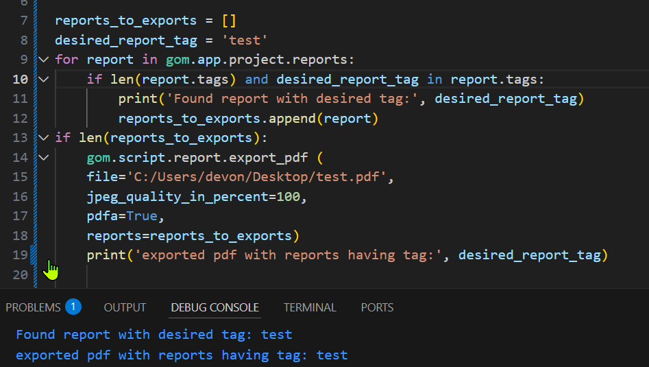

[De...] Posted October 21, 2025 Share Posted October 21, 2025 Please sign in to view this username. - not sure I fully understand, but agree it can be challenging to search for object attributes in vscode, I find it easier to use the "insert element (f2)" in the built in script editor then transfer it over to vscode. Anyways, not sure if this is what you're after, but you can get the report page tags with: "Insert Element (f2)" Object Group -> Elements -> Reports ->Random Report returns gom.app.project.reports['report 87'].tags - [ list of tags ] *random report page then you could do something like: you can get all tags in project with: gom.app.project.all_element_tags ...hope it helps. -devon Link to comment Share on other sites More sharing options...
[Ma...] Posted October 21, 2025 Author Share Posted October 21, 2025 Please sign in to view this username. Hi and thanks - this approach seems like the correct one ( posted python code ). And thanks for that hint with F2 key - never heard/read about it ( or i searched badly 🙂 ) I was able to obtain somehow needed informations, but only gom is telling what's inside - anything after that is no hint. This F2 can help a lot. I hope i'll learn as much as i can while i have trial version at home. Not much of free time while at work for solving coding 😕 Link to comment Share on other sites More sharing options...
