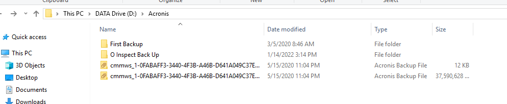

[Ja...] Posted December 5, 2025 Share Posted December 5, 2025 Arrived this morning to find a similar issue with our O-inspect 543... inspectors mentioned issues with the CMM and I found that it was starting a new connection with the SIMULATION configuration and the O-Inspect configuration was nowhere to be found. Checked Acronis first as Please sign in to view this username. suggested and found last backup from.. ~2020.. about when we received the machine so that must have been disabled... Thankfully, using the thread Please sign in to view this username. suggested, https://portal.zeiss.com/knowledge-base?id=483015, I was able to simply add the "O-Inspect" config back as the folder was still present on the computer and everything *appeared* to be restored. It will be a mystery as to what caused this, I can only speculate that someone was tinkering around with what they shouldn't (Or IT?) however I should note though that the C drive was also full... (I am still not sure how/am working that one out) so maybe that was the most likely cause. I went and cleared some low-hanging fruit of data that could be deleted ~about 40gb worth so no longer at capacity. I was receiving some calypso messages about no room on the drive before this. After doing this- I was still finding issues as the automatic stylus changer was working but I was getting this error message in the console: I was able to find what I believe was the fix below by manually loading every stylus we use from the racks manually and then using the Teach ID in the stylus system management. After doing so the automatic stylus changer now works and I do not get the error message anymore. I had a console output for each line assigning the stylus ID. Afterwards I was able to run a program that utilized multiple styli again without issue, so I believe my problem is resolved. Thank you all above for the thread. I hope the Teach ID was valid to do and isn't bad advice. Time to figure out why ACRONIS was backing up. 🙂 Link to comment Share on other sites More sharing options...

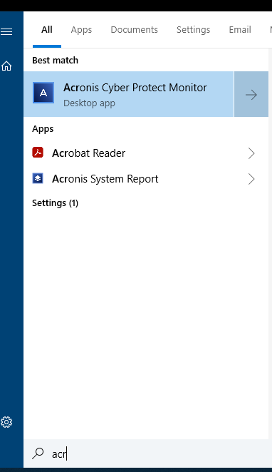

[Ja...] Posted December 5, 2025 Share Posted December 5, 2025 Yeah, Please sign in to view this username. , ACRONIS definitely is not backing up regularly on our O-inspect or our Contura, each only has a backup from the first install + two more shortly after. When I use the ACRONIS help pages in the knowledge base it states to use the "Acronis Cyber Backup" program, but both of ours for example only have the "Acronis Cyber Protect Monitor" which opens up a small window with not much to do stating there is no scheduled backup. Curious if it is just an older version.. if you try to follow anything it leads you to a "Cyper Protect Web Console" that we don't have login details for. I tried playing around for a bit but it is a bit more work than its worth for now and will look into it in the future. We also just had a Duramax install and we never heard anything about Acronis so if there is any old or new additional literature outside of the knowledge base that would be helpful, although for our 2022 Contura Install I was around for it was similarly not mentioned and I have always wondered what Acronis was on the PC. Link to comment Share on other sites More sharing options...
[Ky...] Posted December 8, 2025 Share Posted December 8, 2025 Please sign in to view this username. To my knowledge Acronis has always been set up to backup weekly, at least on the machines we send out. It is configurable, though, so perhaps in the intervening time someone turned it off (IT or something because they were concerned about the backup for some reason). I unfortunately don't have a lot of experience with the Acronis program on the computer itself (it's not on the computers we give to techs or AEs). There should just be a shortcut labelled "Acronis Backup" or something similar on the desktop. There is a password screen, but you should be able to just hit okay through it to my recollection. Do you have an Acronis folder on your D drive? I can't tell for certain, but is it a computer from us and when would you have gotten it? I think we only started giving Acronis around 2020, so its hard to tell. Link to comment Share on other sites More sharing options...
[Ja...] Posted December 10, 2025 Share Posted December 10, 2025 Both Machines came from Zeiss yes, they also both have the separate drive and the files like screenshot below, I am not sure what exactly has stopped it though, likely IT. No Acronis file on the desktop and again... all we seem to have on both computers is this cyber protect monitor that doesn't seem to like doing much of anything. Please sign in to view this username. I appreciate your response. I'll poke around with it myself more /one day/. Link to comment Share on other sites More sharing options...
