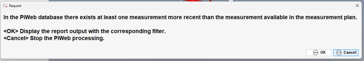

[Xi...] Posted October 10, 2025 Share Posted October 10, 2025 Calypso 2025 patch 8.0.0403 error popped up (see attached snip) when program finished. click Ok will create pi web report. but report was not saved in output file folder. does anyone have same issue? TIA Link to comment Share on other sites More sharing options...
[Ma...] Posted October 10, 2025 Share Posted October 10, 2025 This doesn't seem like error for specific version of Calypso. Usually would be enough to delete database of PiWeb for that program. Or try to look in forum for this error - it was discussed here for older versions of Calypso. 1 Link to comment Share on other sites More sharing options...
[Wo...] Posted October 13, 2025 Share Posted October 13, 2025 This happened to me if I tried to rollback Calypso to older version and then "cheated" the version file in the inspection plan folder. The plan would run, bu then PiWeb would throw this error. That's when I gave up trying to roll back. Link to comment Share on other sites More sharing options...
