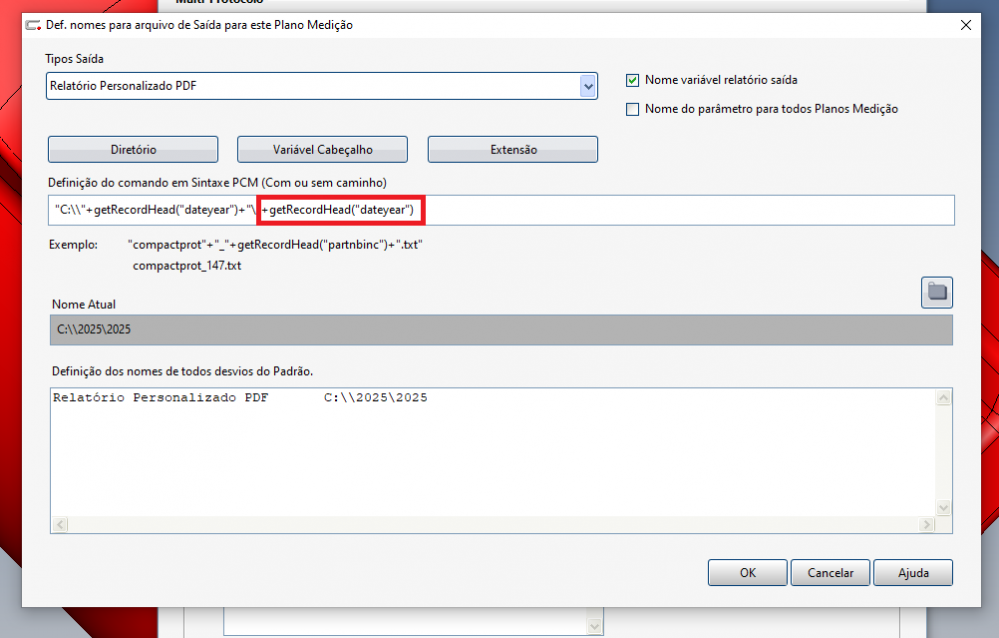

[Da...] Posted October 14, 2025 Share Posted October 14, 2025 Good morning, I would like to add the month to my file saving path. I managed to include the year, but I haven't figured out how to add the month. I have provided an image highlighting where I want to add the month to the folder structure/file name. Is it possible to do this? Thank you very much! Link to comment Share on other sites More sharing options...
[Ri...] Posted October 14, 2025 Share Posted October 14, 2025 d = getRecordHead("date") commaPos = inStr(d, " ") month = subStr(d, 1, commaPos - 1) display(month) Here is the quick and dirty way to isolate the month from the date. If you want it in numerical format, use the following. month = strElement(1, "/", getRecordHead("dateshort")) display(month) Link to comment Share on other sites More sharing options...
[An...] Posted October 14, 2025 Share Posted October 14, 2025 A couple options: // Year date().asDate.year // 2025 // Month (Number) date().asDate.monthIndex // 10 // Month (Word) date().asDate.monthName.asString // "October" // Day (Number) date().asDate.dayOfMonth // 14 // Day (Word) date().asDate.weekday.asString // "Tuesday" For your situation so far: // All together "C:\\" + date().asDate.year + "\" + date().asDate.monthIndex // C:\\2025\10 2 Link to comment Share on other sites More sharing options...

[Da...] Posted October 14, 2025 Author Share Posted October 14, 2025 It worked perfectly, thank you very much. 2 Link to comment Share on other sites More sharing options...

[Cl...] Posted 20 hours ago Share Posted 20 hours ago (edited) "M:\Measurement Results\Zeiss Calypso\CMM\"+getRecordHead("planid")+"\"+getRecordHead("planid")+"__"+getRecordHead("date")+"__"+getRecordHead("time")+"__"+getRecordHead("order")+"__"+getRecordHead("partnbinc")+".txt" This one automatically grabs the program name, date, time and creates a file to store the variable data in the desired location. Edited 19 hours ago Link to comment Share on other sites More sharing options...
