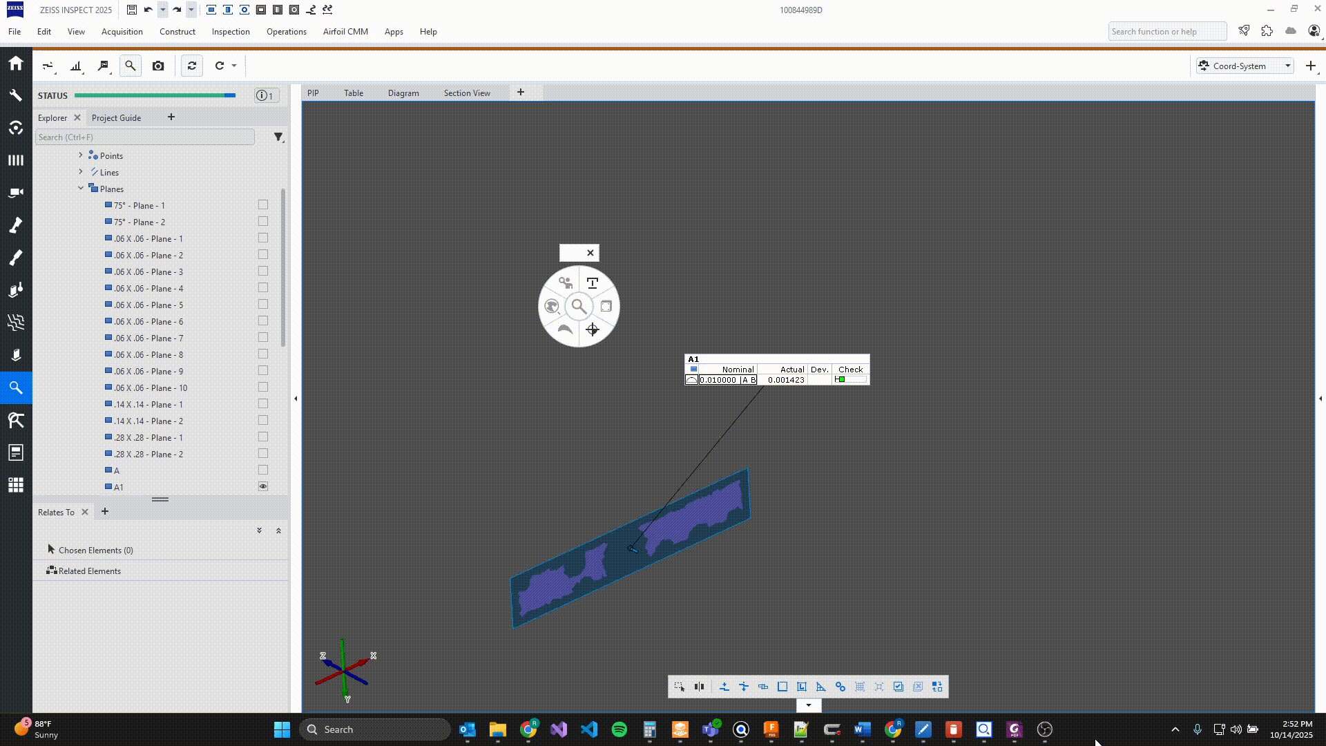

[Ad...] Posted October 14, 2025 Share Posted October 14, 2025 Is there a way to construct a plane and then pull the max/min points from the plane? Link to comment Share on other sites More sharing options...
[Ri...] Posted October 14, 2025 Share Posted October 14, 2025 (edited) Min/Max what? Deviations on a Surface Profile? If that is what you are talking about, create the Surface Profile, then in your Inspect-Wheel - Check - Minimum/Maximum Deviation Label - right click on the Surface Profile - Select All Points of Surface. Edited October 14, 2025 Link to comment Share on other sites More sharing options...
[Ad...] Posted October 14, 2025 Author Share Posted October 14, 2025 I should have been more specific. I'm trying to check a drop. Is there a way to pull the max/min from a plane or surface created? Link to comment Share on other sites More sharing options...
