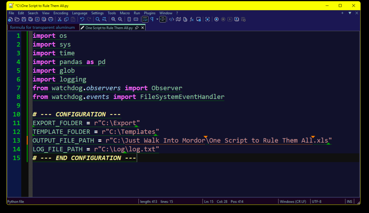

[Ri...] Posted October 17, 2025 Author Share Posted October 17, 2025 (edited) I would like to use python, VBS or similar, but I have IT. 😑 I can't use certain languages, but I can use VB.net and create an app. Wierd... Edited October 17, 2025 Link to comment Share on other sites More sharing options...
[Ed...] Posted October 23, 2025 Share Posted October 23, 2025 If you can download a file from the internet you can use python. You have to be a bit crafty and install it and access it 'manually'. You don't need to have admin permissions to do this. I don't remember all that is required after but you download the 'embedded' version of python. 1 Link to comment Share on other sites More sharing options...
[Ri...] Posted October 24, 2025 Author Share Posted October 24, 2025 I would have to get permission to install Python. Link to comment Share on other sites More sharing options...
[Ma...] Posted October 24, 2025 Share Posted October 24, 2025 If you have Win10 or 11 the nyou can install python from ms store 🙂 Link to comment Share on other sites More sharing options...

[Ed...] Posted November 5, 2025 Share Posted November 5, 2025 Please sign in to view this quote. What I was saying was that no, you don't have to install it in the traditional sense. Likely you can download some files from the internet like pictures, PDFs etc. No company I have ever worked for has completely blocked the ability to do so. That is the extent of network privileges I needed to use it on my company computers. It's much more advanced and probably is 'safer' in that it will have a much more restricted scope when not installed with a path environment variable. 1 Link to comment Share on other sites More sharing options...
[Ri...] Posted November 5, 2025 Author Share Posted November 5, 2025 I found I can install Python in Visual Studio without issues. Link to comment Share on other sites More sharing options...
