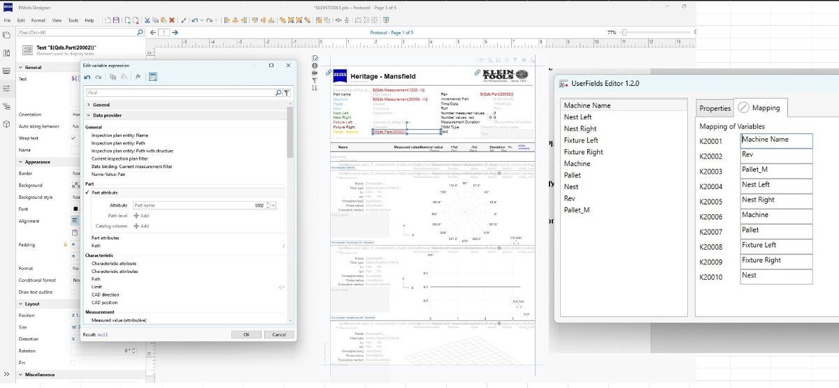

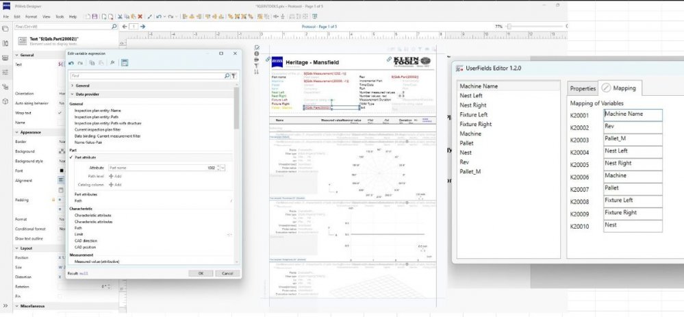

[Lu...] Posted October 15, 2025 Share Posted October 15, 2025 Good morning, We've recently upgrade from 7.0 to 8.0 (FINALLY!!!!!!). And I see custom reports are no longer a viable use. So, I will create my own Template in Designer to accommodate the job. I want to use my custom variables much like I've always used on the Custom Report. Problem is I can't find them in the variable expression. These variables are critical in helping distinguish "areas" throughout the plant. I've done this before many, MANY years ago. Just don't recall what I did. As well, I've searched and searched. Can't find any direct "How-to". The colored lettering are my variables on the template. Pretty proficient in PiWeb but when you don't use it for years, you forget. 🙂 Link to comment Share on other sites More sharing options...
[Ri...] Posted October 15, 2025 Share Posted October 15, 2025 (edited) You need to run the program once with those attributes for it to push to the database for you to see them inside of PiWeb, and they will be under Measurement, not Part. Otherwise you can just directly enter the K value. ${Qdb.Measurement(20001, -1)} through ${Qdb.Measurement(20010, -1)} Edited October 15, 2025 2 Link to comment Share on other sites More sharing options...
