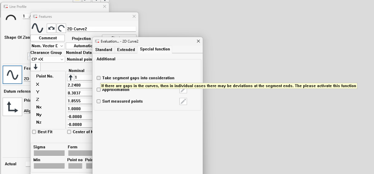

[Ni...] Posted October 17, 2025 Share Posted October 17, 2025 Correct me if I'm wrong. But in this circumstance, under evaluation>special function> Checking the "segment end gaps" box will be useful. Link to comment Share on other sites More sharing options...
