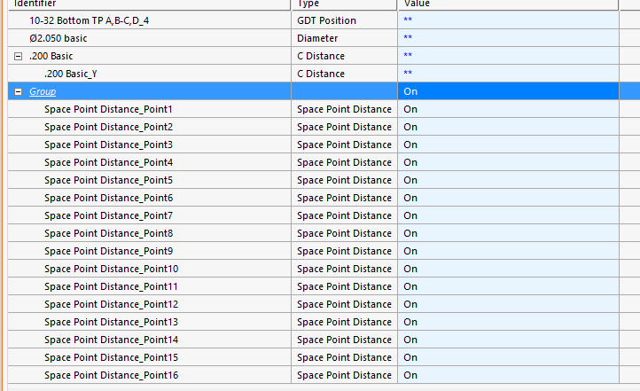

[Jo...] Posted October 17, 2025 Share Posted October 17, 2025 Anyone know how to turn off the Group names of characteristics in Calypso from Piweb... not hide them... not have them calculated at all. They show up as "measured data" and throws off our "not calculated" feature. Note I am running the base Calypso 2022.. and i cannot upgrade or install anything at this time. Link to comment Share on other sites More sharing options...

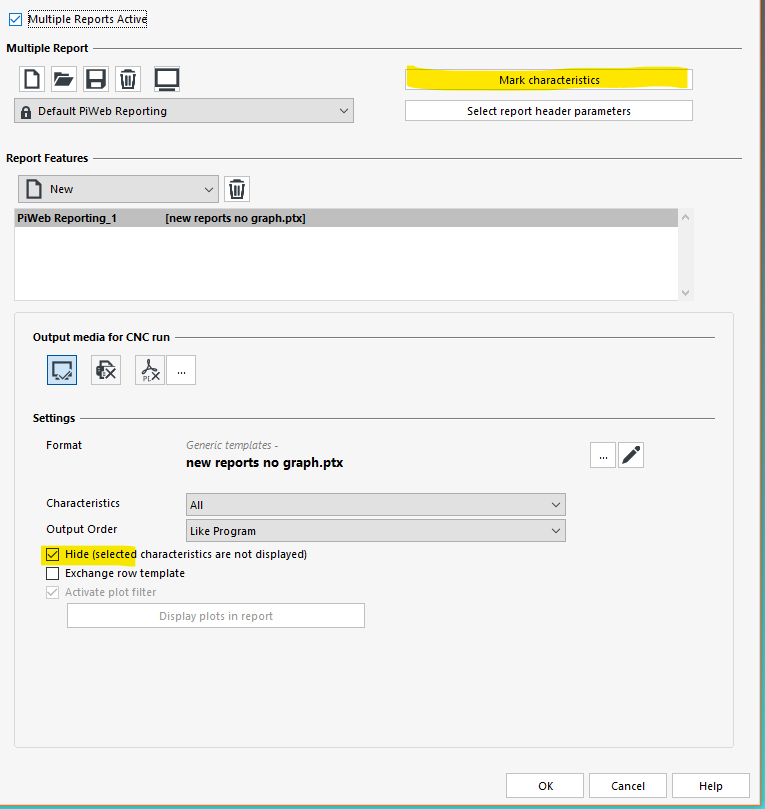

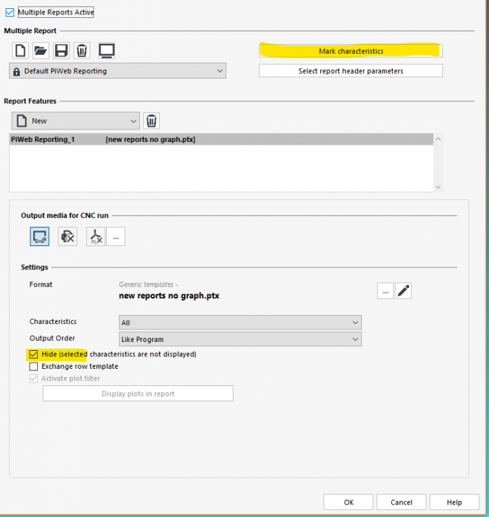

[Du...] Posted October 17, 2025 Share Posted October 17, 2025 I believe you just go into your multiple report page and click on mark characteristics and pick what you need then click on hide selected and they should not come up on the report Link to comment Share on other sites More sharing options...
[Jo...] Posted October 20, 2025 Author Share Posted October 20, 2025 I tried that, but it did not work.... it may be the version I am using... had issues with other things in another post. I had to start over again to get it to work. I am hoping they will install the latest version soon..... Link to comment Share on other sites More sharing options...
[Jo...] Posted October 21, 2025 Author Share Posted October 21, 2025 I figured something out with the help of Zeiss... 2008 will return "Logical group" for the group names. Just figured out how to use that to make a text field to register 0 or 1, then add all the fields up to subtract from my total. Probably a more elegant or simpler way to do it, but it works. Link to comment Share on other sites More sharing options...
