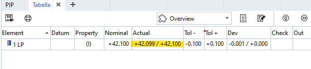

[Zu...] Posted October 21, 2025 Share Posted October 21, 2025 Hallo, Wie kann man alle Projektstufen in eine DFQ exportieren? Wie funktioniert der Export bei einem Zweipunktmaß – Min und Max sind in der selben Zeile! Danke Stefan Link to comment Share on other sites More sharing options...
[Ma...] Posted October 21, 2025 Share Posted October 21, 2025 Stages are the most unfinished feature in Inspect. I believe you can export stages separately - manually or by python script. If you are interested how it's exported, then try it out - exported file is readable text file. Link to comment Share on other sites More sharing options...
[Zu...] Posted October 22, 2025 Author Share Posted October 22, 2025 Thanks, I know some stages work, but I wanted to put them all in a DFQ file Stefan Link to comment Share on other sites More sharing options...
[Na...] Posted October 22, 2025 Share Posted October 22, 2025 Hi, there is a QDAS export template for stages for free in the software store: https://software-store.zeiss.com/de/products/apps/export-qdas-stages-mtu I think the "worst case" value is exported for this check. If both are needed, a user defined check could be used. Nanno Link to comment Share on other sites More sharing options...
