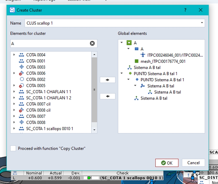

[Ir...] Posted October 22, 2025 Share Posted October 22, 2025 (edited) Hello, I'm developing a script that takes an existing cluster as input. However, I'm struggling to find a reliable way to retrieve the list of elements that belong to that cluster within the script. The only alternative I can think of is searching by name, since the cluster elements are automatically renamed with the cluster name as a prefix. Still, this approach doesn't seem robust enough. Do you know of any keyword or method that could help in this situation? I've tried keywords like dependency_children and dependency_elements, but without success. Thanks in advance Edited October 22, 2025 Link to comment Share on other sites More sharing options...

[Ir...] Posted October 22, 2025 Author Share Posted October 22, 2025 When you create a cluster, you add a list of elements, see the image attached as an example: The script I'm working on assumes that the cluster has already been created, and the only input it receives is the system associated with the cluster (the reference system that is generated when the cluster is created). Based on that information, is there any way to retrieve all the elements from the cluster's creation list? Link to comment Share on other sites More sharing options...

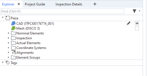

[Ir...] Posted October 30, 2025 Author Share Posted October 30, 2025 Thank you very much for your response. I’m reviewing the link you shared about cluster evaluation, and another question came up. The "Clusters" field doesn’t appear in my explorer. Could this be due to the version of ZEISS Inspect I’m using? Link to comment Share on other sites More sharing options...
[Ma...] Posted October 30, 2025 Share Posted October 30, 2025 Yes, this might be the case. The cluster concept has been introduced in ZEISS INSPECT 2025. The "Element Groups" show in your Explorer screenshot works differently. Link to comment Share on other sites More sharing options...
