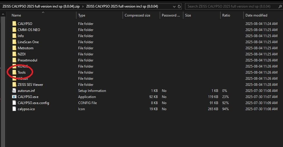

[Mo...] Posted October 23, 2025 Author Share Posted October 23, 2025 Please sign in to view this quote. I'd like to be able to print the old graphics elements too, where do I find this TOOLs folder? Link to comment Share on other sites More sharing options...
[Ma...] Posted October 23, 2025 Share Posted October 23, 2025 Please sign in to view this quote. I think you can edit font size in template editor - in userfield is only content. Link to comment Share on other sites More sharing options...
[Th...] Posted October 23, 2025 Share Posted October 23, 2025 Please sign in to view this quote. It's bundled with the installer for Calypso. If you don't have that you can download it from the Zeiss portal. Link to comment Share on other sites More sharing options...

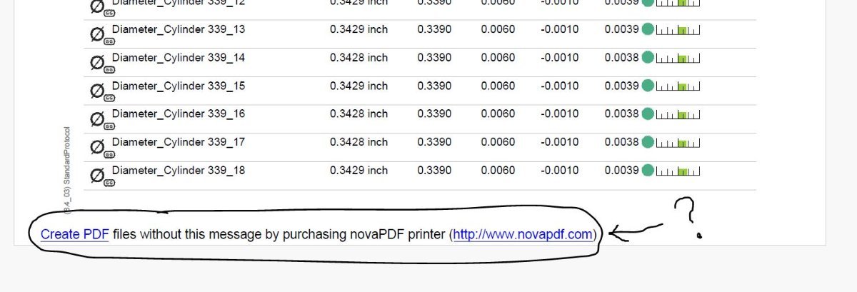

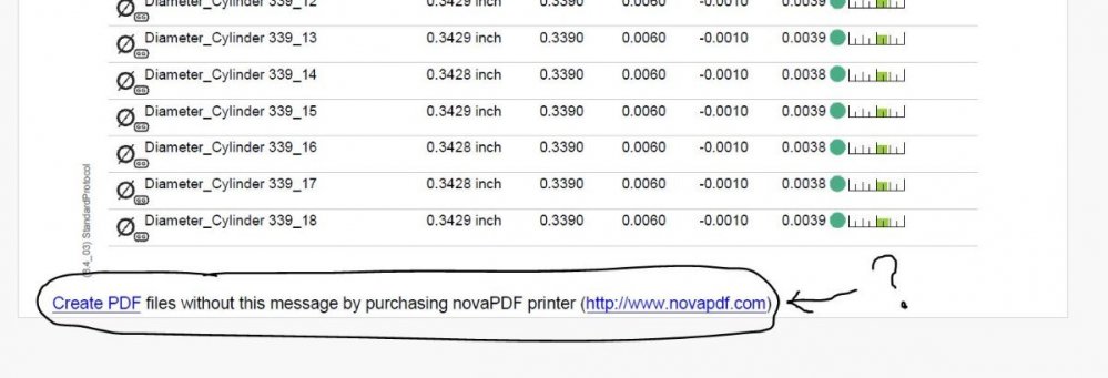

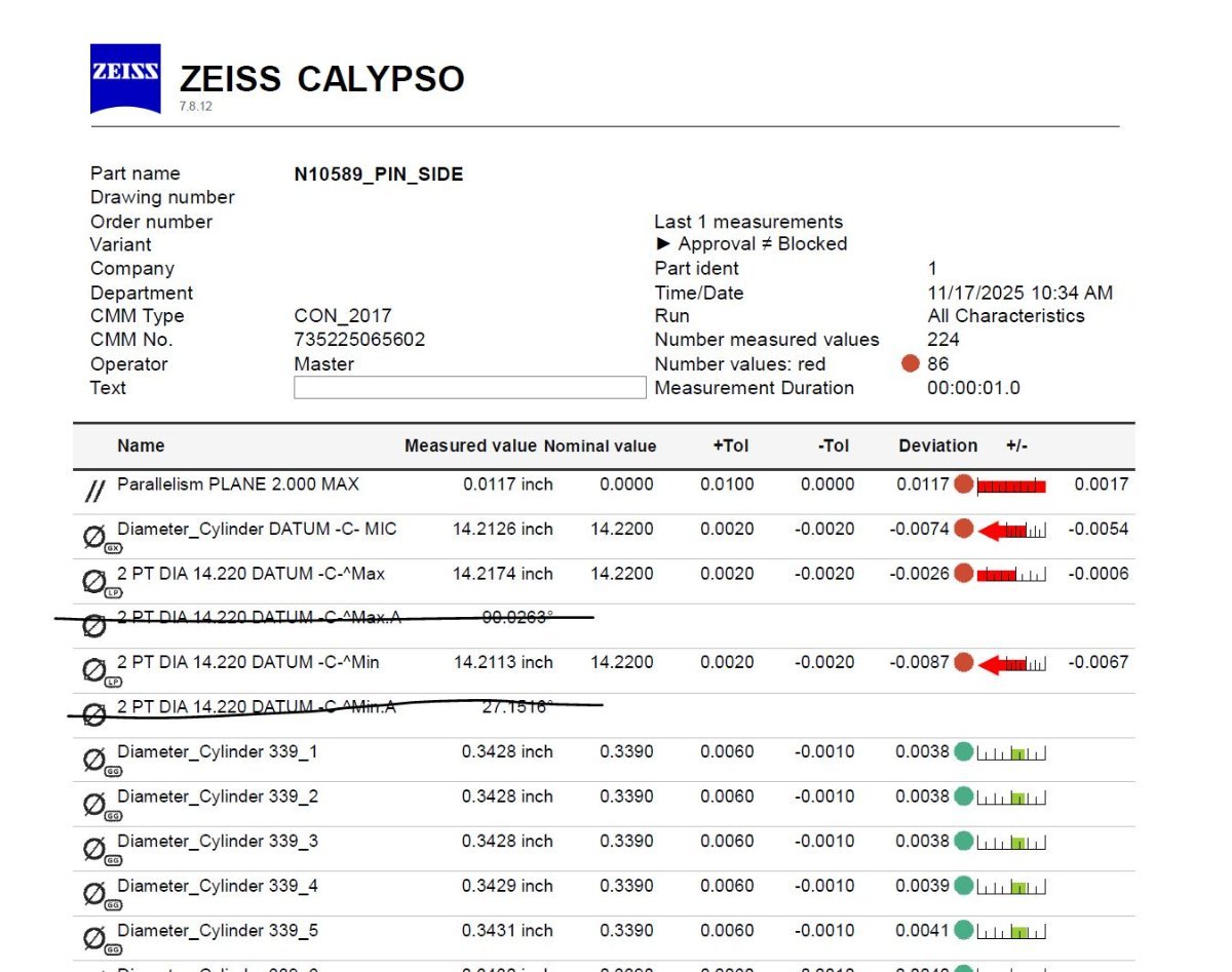

[Ze...] Posted November 17, 2025 Share Posted November 17, 2025 I haven't used Calypso since the Custom Report days. What's the easiest way to implement Piweb for dummies? What I'd like to do... Remove the M/L and other data labels in the reports Add position plots for hole patterns when needed Add Form plots for Flatness, etc. when needed Customize the report header and other pages I tried using the Standard Protocol. Here's what I got... How to remove the unwanted dims and the M/L labels (on another page) What's with the novapdf message? We don't have what we need already? Link to comment Share on other sites More sharing options...
[Ze...] Posted November 17, 2025 Share Posted November 17, 2025 I signed up for PiWeb Training online. Hopefully that gets me going. Link to comment Share on other sites More sharing options...
