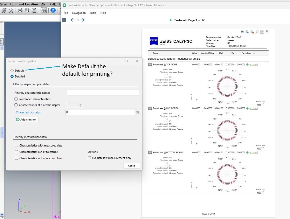

[Ri...] Posted October 29 Share Posted October 29 I have one PiWeb report that always comes up as "Detailed" when printing, this means about 8 pages of graphs, the operator has to manually select "Default" to print a simple report. How can I make this print at "Default" and let the operator decide if they want a "Detailed" report? Link to comment Share on other sites More sharing options...

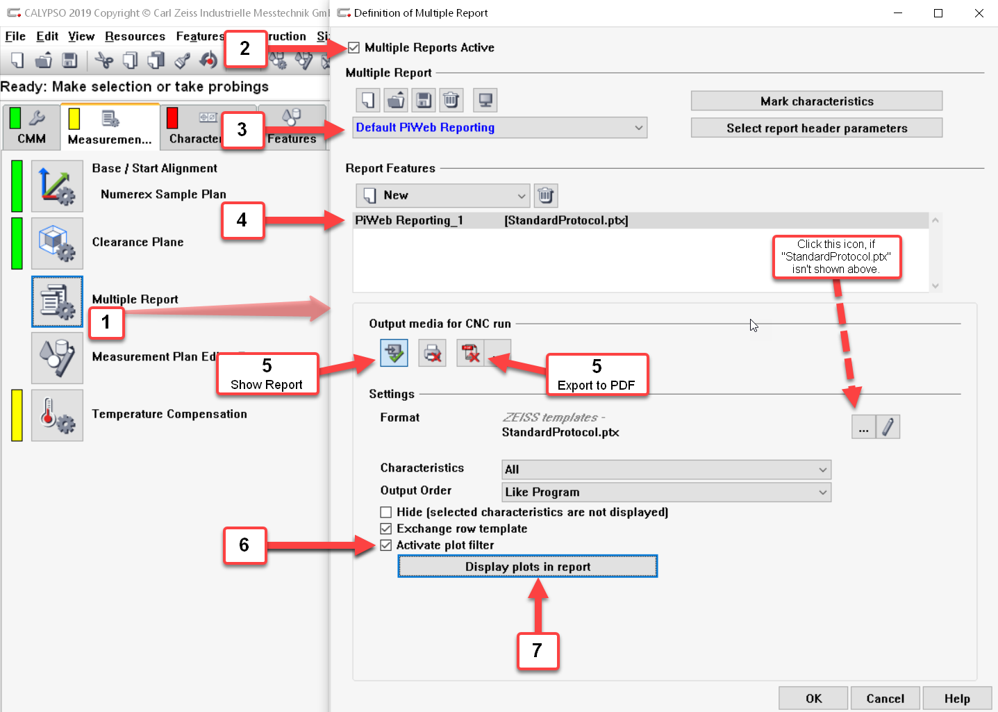

[An...] Posted November 6 Share Posted November 6 Hi Rich, My thought is that this report has "Exchange Row Template" checked in the multiple report window. My apologies that this image doesn't have it labeled, but you should have that unchecked. 1 Link to comment Share on other sites More sharing options...
[Ri...] Posted November 7 Author Share Posted November 7 It's a custom template, but "Exchange Row Template" seems to have set it to "Default". Thank you. Link to comment Share on other sites More sharing options...
