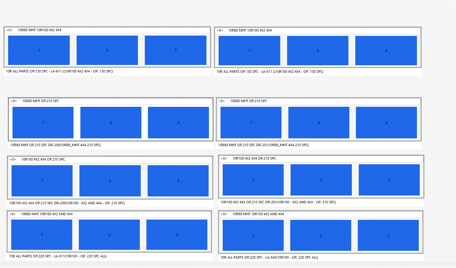

[Mo...] Posted October 30, 2025 Share Posted October 30, 2025 Is there still no way to add pictures to pallets? (Just upgraded from 6.2 to 8.0) Or change colors or any way to identify them better than the small text for the name and comments? I have a desk with various program, each running 3 parts. How do I make them easier to differentiate so it's not just a bunch of blue boxes? Link to comment Share on other sites More sharing options...

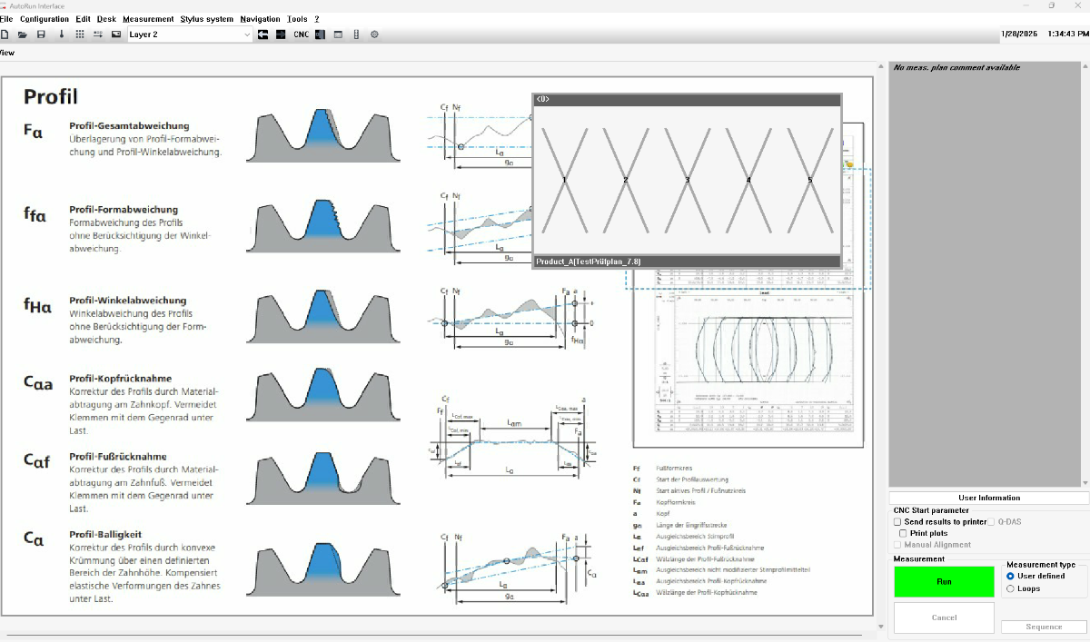

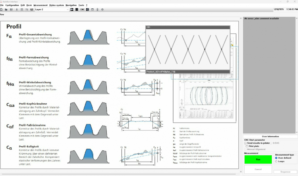

[Ma...] Posted January 28 Share Posted January 28 Hello Monika, unfortunately you can't set up pictures for the pallet programs itself, that only works for single programs/inspections. But if you create different Layers for the Pallets, for example by customer or by product you can use background pictures to individualise it and make an easier overview: Best Regards Marcel 2 Link to comment Share on other sites More sharing options...
[Jo...] Posted January 28 Share Posted January 28 You can add a dummy inspection plan (a plan with no data), add pictures/instructions, and place it next to the pallet as a workaround. 3 Link to comment Share on other sites More sharing options...
