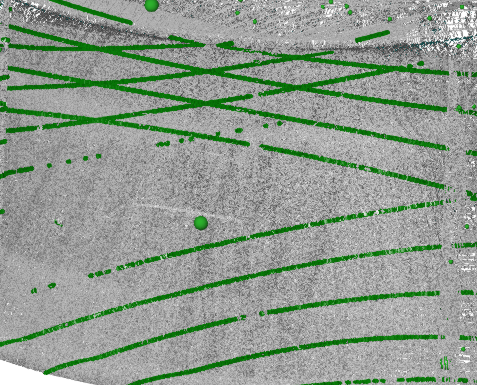

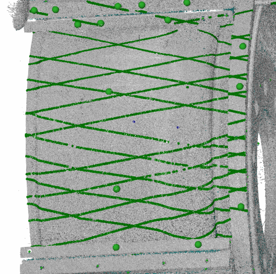

[Lo...] Posted October 31, 2025 Share Posted October 31, 2025 I've noticed that in the morning my scans are cleaner and easier to achieve and this is in part to all of my scan lines being present and solid, but after a few hours about a quarter of my scan lines disappear entirely. I can still see them present with my eyes but the camera seems to ignore them. I suspect the scanner's temperature to be a cause as it seems to resolve if I unplug the scanner for a while, and the area the lines are missing from is the same half of the scanner that gets pretty warm. Is this common or should I be unplugging the scanner all the time? It's used with enough frequency this might be an issue in the long term. Link to comment Share on other sites More sharing options...
[Lo...] Posted February 17 Author Share Posted February 17 Update: This issue has resolved with a full calibration after a warm up period. Seems it was a temperature difference after all. 1 Link to comment Share on other sites More sharing options...
