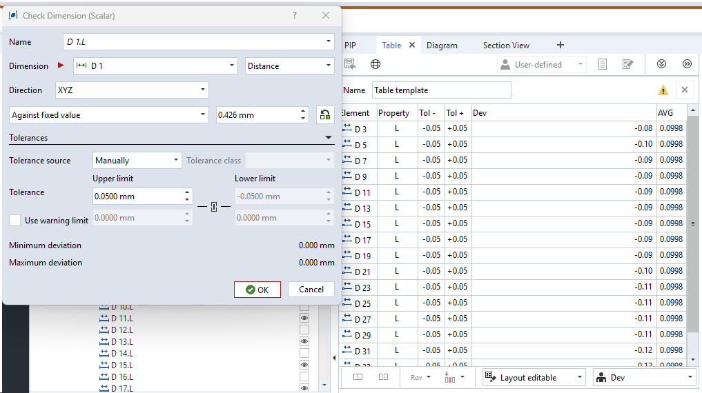

[Ma...] Posted November 3 Share Posted November 3 Good morning to all, I have to use a average value as nominal intead of the cad nominal, but I don't know if it's possible and how to do it if it's possible. In my case I have to use the average value between all D element (D 1, D3, D5, D7 etc etc) and check if the measured values are in tolerance (in my case ±0.05) respect to the average. I can calculate it, but I want to know if it's possible tu automate this check. Thank you very much. Link to comment Share on other sites More sharing options...

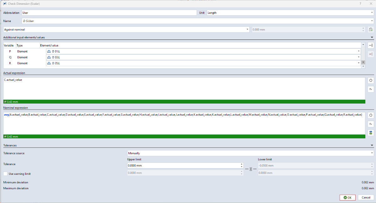

[Ma...] Posted November 3 Share Posted November 3 (edited) You would have to use User defined check - where you can calculate nominal value. In that you can add more variables, select which elements you want - it will add variables as "A", "B" - in nominal you can access them as A.nominal. In Fx button there should be AVG function Edited November 3 Link to comment Share on other sites More sharing options...

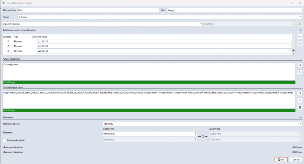

[Ma...] Posted November 3 Author Share Posted November 3 Hello, thank you! I know this function, but I didn't think to use it 😄 This is how I did it, in case another user wants to use this function. Thank you very much! 1 Link to comment Share on other sites More sharing options...
