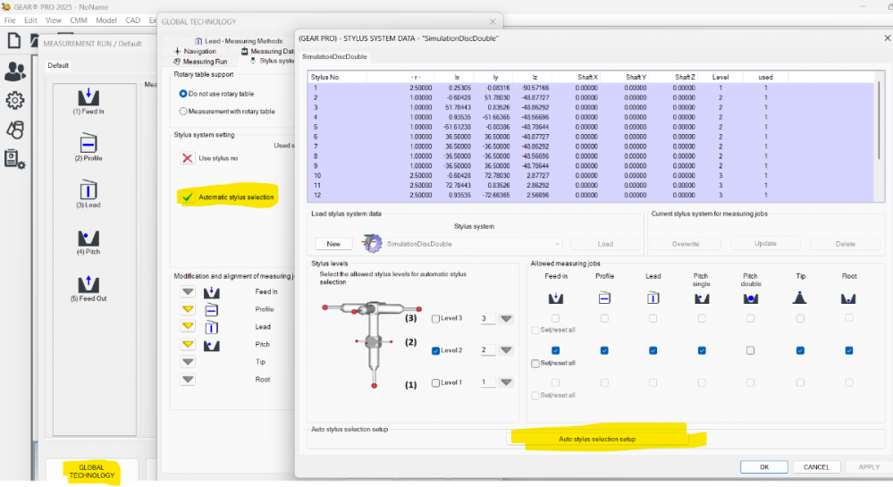

[Fe...] Posted November 4 Share Posted November 4 why during the measurement cycle of an internal toothing, suddenly stopsIMG_1345.HEICIMG_1345.HEICIMG_1345.HEICIMG_1345.HEIC Link to comment Share on other sites More sharing options...
[Ed...] Posted November 5 Share Posted November 5 Check the stylus system! Check if you have selected the correct stylus for every work (Feed-in, Profile, lead etc.) Do you use RT? Is there one stylus for every work? Link to comment Share on other sites More sharing options...
[Fe...] Posted November 5 Author Share Posted November 5 I USE A DOUBLE STAR 0.3 AND 0.5 I DON'T HAVE A ROTATING TABLE Link to comment Share on other sites More sharing options...
[Ed...] Posted November 6 Share Posted November 6 Please sign in to view this quote. Did you check every measuring job have correct stylus? For me it looks like it can`t perform even feed-in job. Link to comment Share on other sites More sharing options...

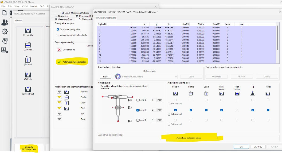

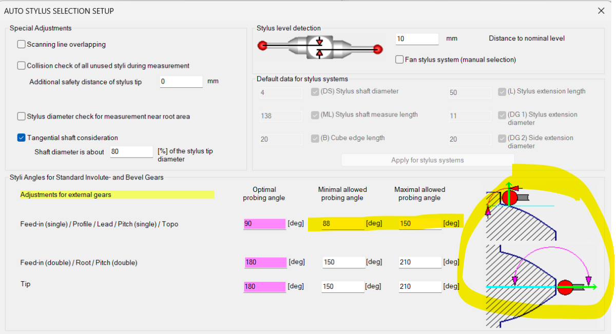

[Ro...] Posted November 12 Share Posted November 12 Hi, I assume you use the automatic stylus selection (Picture (1))? If yes, the message tells you that the styli can´t reach the measurement positions or can measure the gear. Reasons can be various, e.g. stylus tip diameter too large, space in the gear to low, shaft contact detection is defined too secure, ... You can try to change the settings in the dialoge "Auto stylus selection setup" (Picture (2) yellow markings). But be careful with your changes as collisions can occour. 1 Link to comment Share on other sites More sharing options...
