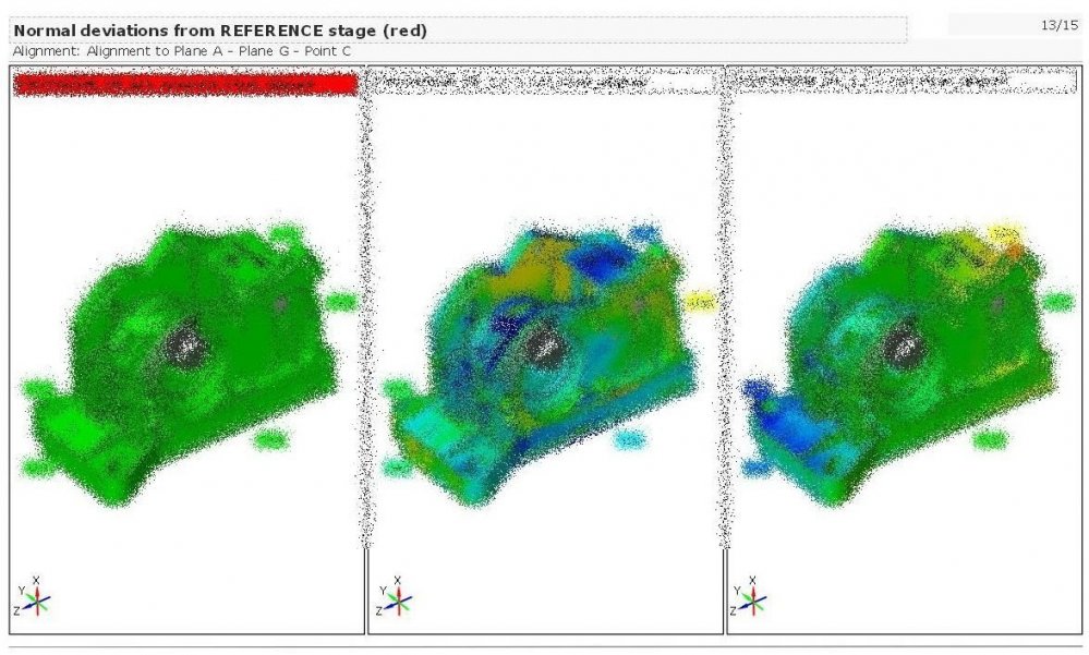

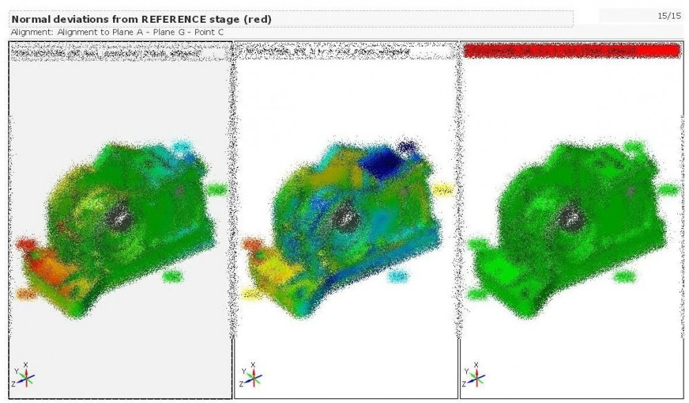

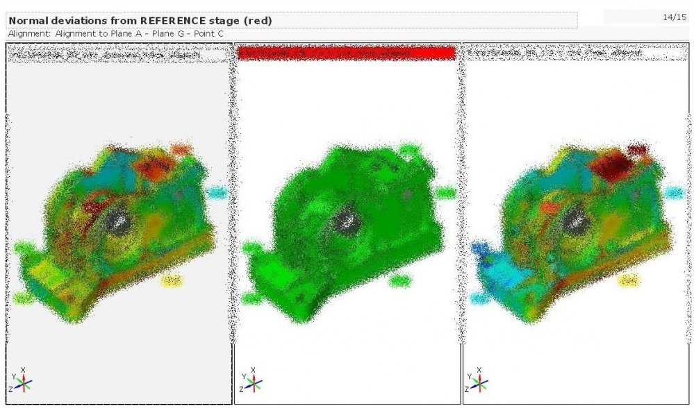

[Ro...] Posted November 24, 2020 Share Posted November 24, 2020 (edited) There is missing function which will update current report page for current "Reference stage" in Stage project. Report examples are attached, there is needed many clicks now (V2020 HF1) to reach the updated page for another reference stage. Edited November 24, 2020 Link to comment https://qualityforum.zeiss.com/topic/25-wish-add-reference-stage-parameter-to-reconfigure-report-page/ Share on other sites More sharing options...
[Ch...] Posted December 3, 2020 Share Posted December 3, 2020 Dear Robert, Thank you for the Feedback, we take this as a wish. There exist already a solution via script. Simply set the desired reference stage, then select the report pages you want to convert and then call this script: reconfigure_deviation_reference.py Link to comment https://qualityforum.zeiss.com/topic/25-wish-add-reference-stage-parameter-to-reconfigure-report-page/#findComment-63 Share on other sites More sharing options...
