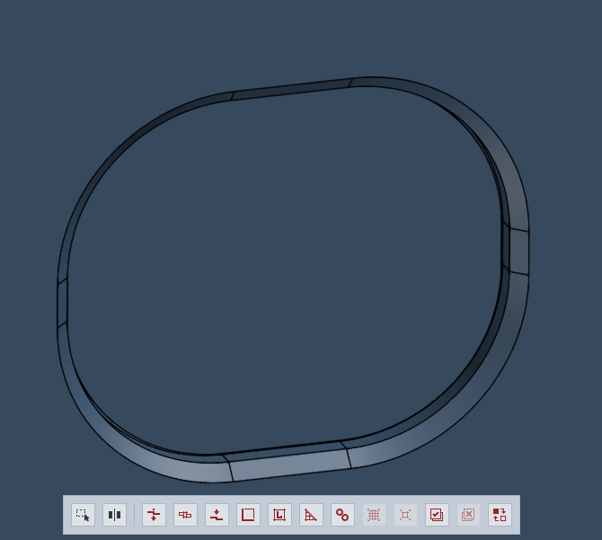

[ga...] Posted November 5, 2025 Share Posted November 5, 2025 What feature should be used to measure the best fit plane distances between these two surfaces Link to comment Share on other sites More sharing options...
[Na...] Posted November 10, 2025 Share Posted November 10, 2025 Hello Gaurav, many ways to evaluate the distance between planes: https://techguide.zeiss.com/en/zeiss-inspect-2025/article/faq_how_to_evaluate_the_distance_between_planes.html Maybe a position tolerance with min/max deviation labels works for you (activate color deviation representation in the properties first)? Nanno Link to comment Share on other sites More sharing options...
