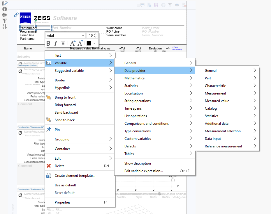

[Lu...] Posted November 6, 2025 Share Posted November 6, 2025 Hello, I am trying to add in the "Shift" variable to my piweb report, but I am not finding it in the "variable" drop down lists in the piweb editor. Am i just blind and not seeing it? I have been searching around for a while now and am wondering if i have to type in the viariable "code" manually for it to show up which I am not sure how to do. I have multiple programs that use this variable so it would be great to add it into a report. I have already created a custom piweb report that doesnt have the "shift" variable, but now im making a different one and i cant seem to find it anywhere. Any help is appreciated, thank you! Link to comment Share on other sites More sharing options...
[Du...] Posted November 6, 2025 Share Posted November 6, 2025 been a long time since i set mine up, but it looks like my custom fields were in variable/data provider/reference measurement. Dont know if that will help you or not 1 Link to comment Share on other sites More sharing options...
[Th...] Posted November 6, 2025 Share Posted November 6, 2025 ${Qdb.Measurement(850, -1)} is the variable for shift. 1 Link to comment Share on other sites More sharing options...

[Lu...] Posted November 14, 2025 Author Share Posted November 14, 2025 Ok i think im understanding it now. Day would be 0, night would be 1, and weekend would be 2. the negative numbers are the last part that was ran, so -1 would be the most recent part ran, and -2 would be the one before. I think im understanding it now thank you for your patience! As im trying to put in the variable for "machine number" it is returning the error "cannot convert argument 1 from double to integer". I believe i have typed in the variable correctly, i have also tried it without the ",-1" added and the same error is returned. I have it typed in as: ${Qdb.Measurement(10/4062,-1)} i have tried googling this error and i havent found much (at least, nothing that made sense to me/applied to calypso from what i could tell). Link to comment Share on other sites More sharing options...
[Lu...] Posted November 14, 2025 Author Share Posted November 14, 2025 Please sign in to view this quote. Actually as im rereading Thomas's post i think im still misunderstanding lol, im going to think about this more. Thanks Link to comment Share on other sites More sharing options...
[Ri...] Posted November 14, 2025 Share Posted November 14, 2025 I don't believe 10/4062 is a valid K field. Link to comment Share on other sites More sharing options...
[Lu...] Posted November 14, 2025 Author Share Posted November 14, 2025 Please sign in to view this quote. This is what i have in the "report header parameters" menu Link to comment Share on other sites More sharing options...
[Ri...] Posted November 14, 2025 Share Posted November 14, 2025 It should be "${Qdb.Measurement(10, -1)}" 4062 is most likely the catalog that it pulls from. 1 Link to comment Share on other sites More sharing options...
