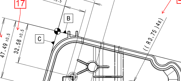

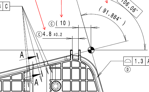

[Ma...] Posted November 8, 2025 Share Posted November 8, 2025 Hi everyone, How I can create alignment like this? A is a plane, references B and C are not perpendicular to each other, they are at an angle of 91.884°. When I try to create an alignment based on these references, the software automatically adjusts it to 90°. Thanks for your help, Link to comment Share on other sites More sharing options...

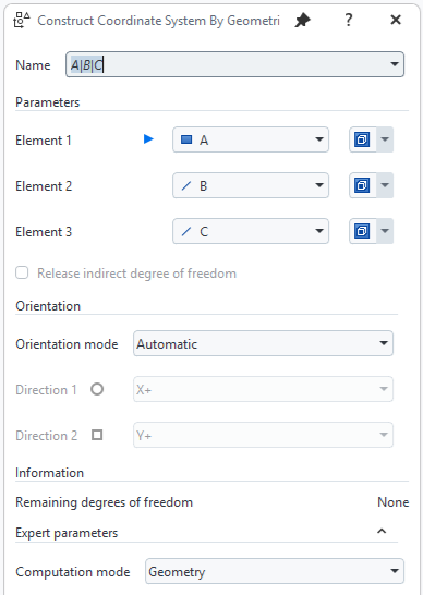

[Ma...] Posted November 8, 2025 Share Posted November 8, 2025 Turn method to Geometry instead of ISO Link to comment Share on other sites More sharing options...
[Ma...] Posted November 8, 2025 Author Share Posted November 8, 2025 still the same problem Martin Link to comment Share on other sites More sharing options...

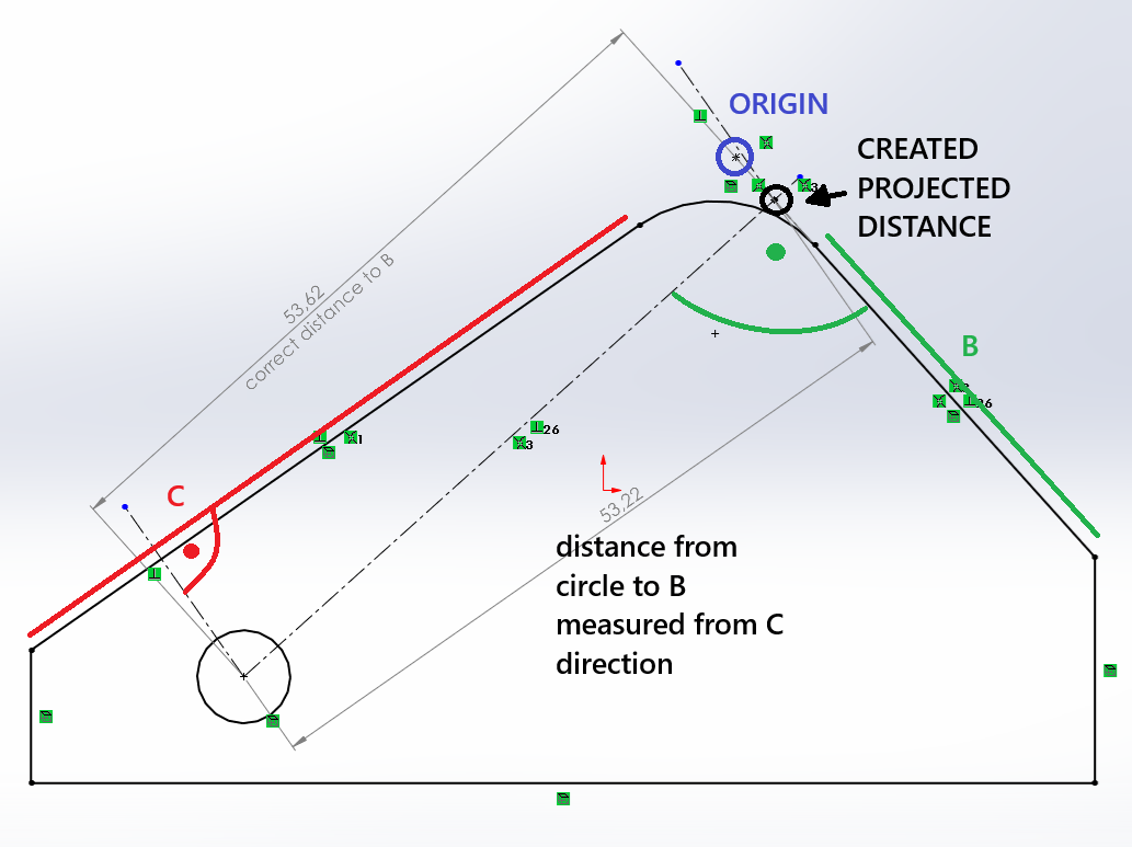

[Ma...] Posted November 9, 2025 Share Posted November 9, 2025 So i did a research with help of SolidWorks. I did construct coordinate system by geometries like this Then i did create projected distance: circle/point from cylinder and B - used referenced construction. Then i reported distance X and selected correct coordinate system. It was giving me correct nominal. Here is what i got when i created bad coordinate system ( A|C|B ) and measured projected distance circle->B Link to comment Share on other sites More sharing options...
[Ma...] Posted November 9, 2025 Author Share Posted November 9, 2025 Thank you very much Martin, i will try it with your method 🙂 Link to comment Share on other sites More sharing options...

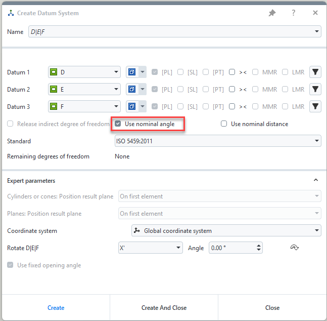

[Ch...] Posted November 10, 2025 Share Posted November 10, 2025 Additional hint: You can create an alignment from a nominal and actual datum system, and inside the datum system dialog you can find a option to use nominal angle instead the 90 degrees defaults. If I understood your problem correctly, this can save some construction work. Afterwards you have construct a datum system from your elements, simple create an alignment using Hope this helps, Christoph Schult 1 Link to comment Share on other sites More sharing options...
[Ma...] Posted November 14, 2025 Author Share Posted November 14, 2025 Thank you Christoph Link to comment Share on other sites More sharing options...
[Jo...] Posted November 14, 2025 Share Posted November 14, 2025 Please sign in to view this quote. Coming from CMM with age old software, this would have also been my approach and a point is enough for the last degree of freedom. 1 Link to comment Share on other sites More sharing options...
