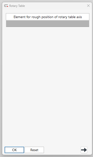

[Ma...] Posted November 12, 2025 Share Posted November 12, 2025 Hello everyone, I am currently working with three Zeiss Duramax machines: one with Calypso 2014 and a rotary table, two with Calypso 2024 (without rotary table), and one offline station with Calypso 2024 (currently without a rotary table). My goal is to update the Duramax running Calypso 2014 to Calypso 2024, so that I can also create and simulate rotary table programs on the offline station. I have already managed to configure the rotary table in the CMM settings so that it appears in the measurement plan settings. However, the following error message appears: Please sign in to view this quote. Does anyone know how to solve this issue? What do I need to configure or load so that the rotary table is properly recognized and visible in the simulation on the offline station? Thank you very much in advance! Best regards, Marco W. Link to comment Share on other sites More sharing options...
[Ri...] Posted November 12, 2025 Share Posted November 12, 2025 https://portal.zeiss.com/knowledge-base?id=855892 Here is a Knowledge Base article that will get you going. Link to comment Share on other sites More sharing options...
[Do...] Posted January 16 Share Posted January 16 Apologies for piggybacking here, but I've run into the same issue regarding the axis portion of the rotary setup offline. While following the guide provided by Richard, on step 16 my window does not show the rotary table images as depicted, nor does it have an option for main orientation. It only shows the button for “Feature for rough pos. of RT axis”. Am I missing another setting or perhaps there is an issue with my Calypso installation? I made changes to the text file as noted at the end of the guide, but that did not address the issue. Thanks, Don Link to comment Share on other sites More sharing options...
