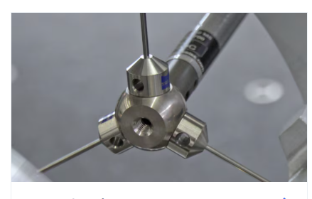

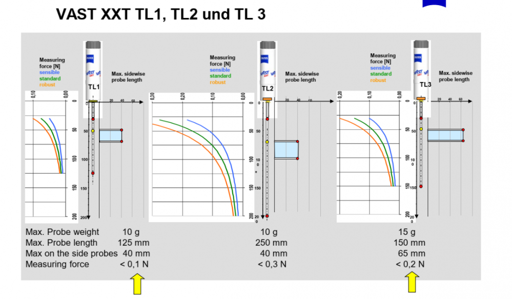

[Ri...] Posted November 13, 2025 Share Posted November 13, 2025 The XXT on a Spectrum is typically the TL3 which is the most common configuration (you obviously need to confirm which configuration you have). Either way, yes it supports star styli. There are limitations to it though. Weight, length, and how far out axially you build the stylus system (you will see that there is essentially a "goldilocks'-zone" of where you can extend the stylus system out axially). While you can build your own star, Zeiss sells pre-built systems for you to buy. Below is the link for the TL3 ones. https://shop.metrology.zeiss.com/INTERSHOP/web/WFS/IMT-US-Site/en_US/-/USD/ViewStandardCatalog-Browse?CategoryName=330322&CatalogID=300000 1 1 Link to comment Share on other sites More sharing options...

[Jo...] Posted November 19, 2025 Share Posted November 19, 2025 Its worth noting that if you DONT buy the adapter plate linked above, and just buy an extension and a 4-way connector you will also need to obtain the $$$ stylus squaring system. It is highly recommended to buy the above preassembled adapter plate Link to comment Share on other sites More sharing options...

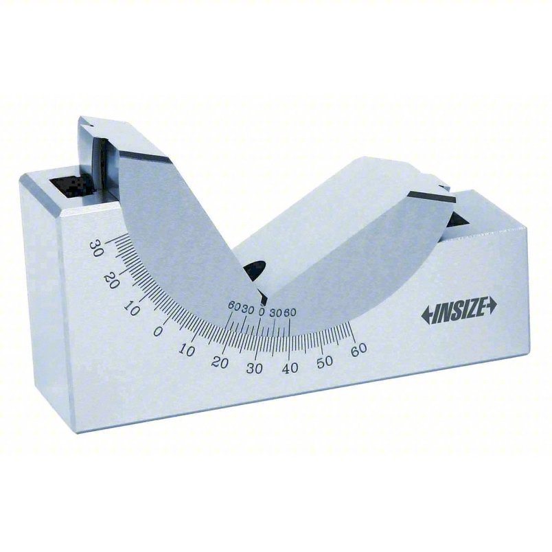

[Ri...] Posted November 20, 2025 Share Posted November 20, 2025 I use one of these (See image) and I can set any angle or compound angle that I need plus I align my styli with an indicator to at least one axis. 1 Link to comment Share on other sites More sharing options...
