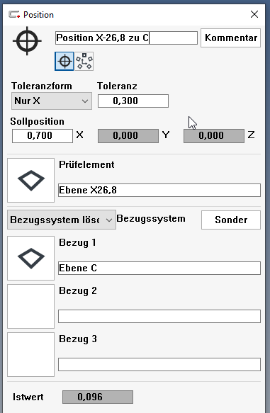

[Ka...] Posted November 13, 2025 Share Posted November 13, 2025 Dear Experts, Using CALYPSO 7.4.24 🙂 We have two planes with a nominal Distance of 0.7mm. The drawing specifies a position tolerance between the planes, which is ultimately nothing more than the simple distance. The compensation method is standard Gaussian. However, when I use the ‘M-Distance’ or ‘Plumb’ test element, different distances are output. ‘M-Distance’ or ‘Lot’ deliver similar values using different Filter. Position -> E zu C M-Distanz Lot Gauß 0,748 Zentrum Gaus 0,724 Gauß 0,724 Minimum 0,748 Zentrum Minimum 0,719 Minimum 0,719 Innen T 0,639 Zentrum Innen T 0,693 Innen T 0,693 Außen T 0,774 Zentrum Außen T 0,742 Außen T 0,742 Minimum Gauß 0,638 Minimum minimum 0,638 Minimum Innen T 0,638 Minimum außen T 0,638 Maximum Gauß 0,786 Maximum Minimum 0,786 Maximum Innen T 0,786 Maximum außen T 0,786 Until now, I assumed that with a position tolerance, the standard is to use the centre of gravity of the reference surface was determined as the point for a perpendicular line to the tolerated surface. I cannot understand the values output from the position tolerance. How exactly is the distance between two planes determined here? This is complete strange to me..😐 Thank you very much for explaining the phenomenon. Regards Karsten Link to comment Share on other sites More sharing options...
[Ma...] Posted November 13, 2025 Share Posted November 13, 2025 (edited) I think that TP for plane will be for the furthest point of that plane - not midpoint or origin point. It works like surface profile or for better understanding - like perpendicularity - it takes either measured points or feature nominal shape ( rectangle ) and reports the furthest point of a corner or measured point from ref. distance. You can try this out with theoretical planes with setted A1,A2 angles Edited November 13, 2025 1 Link to comment Share on other sites More sharing options...
