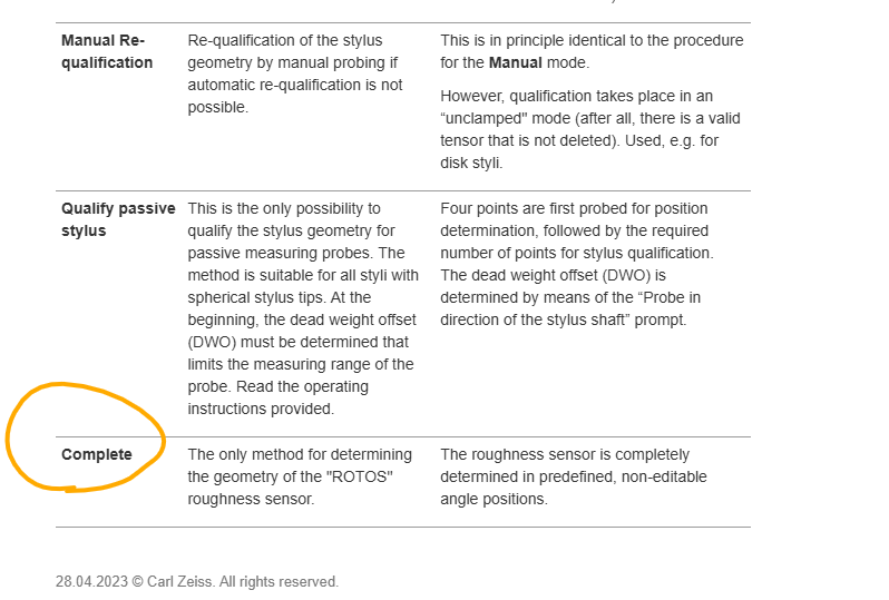

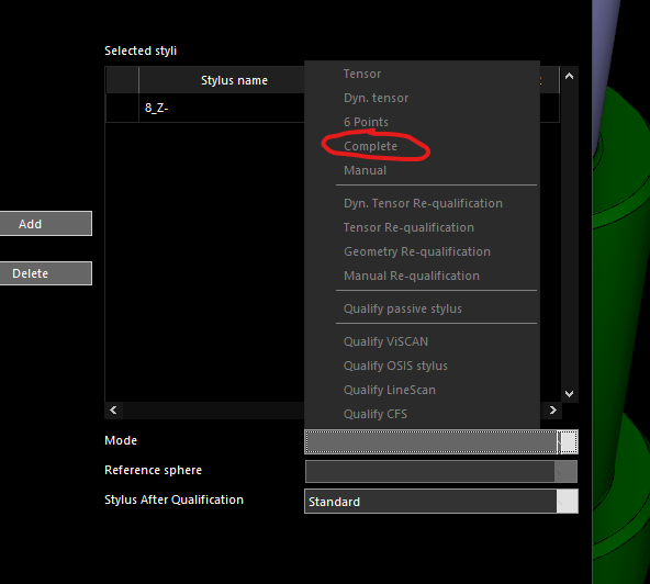

[Wo...] Posted November 15, 2025 Share Posted November 15, 2025 Hi - I've noticed that there is an option for "complete" probing system qualification. Anyone knows what this is? There is nothing in the user guide. Link to comment Share on other sites More sharing options...
[Ch...] Posted November 20, 2025 Share Posted November 20, 2025 2 Link to comment Share on other sites More sharing options...
[Wo...] Posted November 22, 2025 Author Share Posted November 22, 2025 Huh, thanks, don't know how I've missed that one! Link to comment Share on other sites More sharing options...
