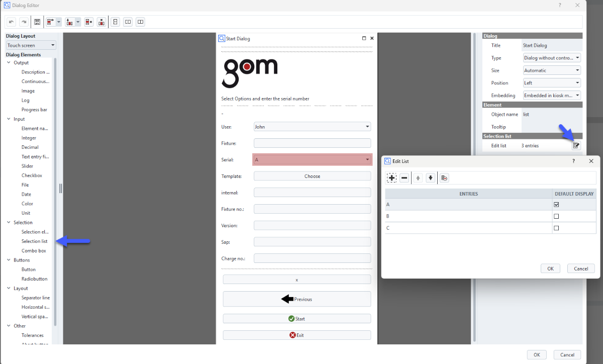

[Na...] Posted November 20, 2025 Share Posted November 20, 2025 If you are using the Kiosk interface, it's easy: You just have to drop a selection list and edit the entries. The Dialog is already part of the Kiosk: 1 Link to comment Share on other sites More sharing options...
