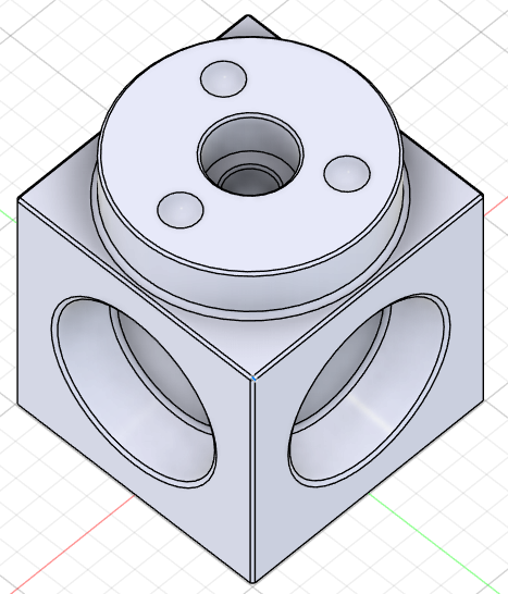

[Ma...] Posted November 18, 2025 Share Posted November 18, 2025 One day i'll bring this alive just to daily/weekly test probes if they are ok ( just to verify if noone lied about crash 😄 ) Using ref. sphere in those 3 rounded dips to lock rotation and primary. On sides are 4 cones to cover all probe tips - cones just to solve not perpendicular placement. Intended to be from stainless steel. For us it's better than risk damaging ref. sphere. 1 1 Link to comment Share on other sites More sharing options...
