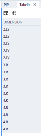

[JO...] Posted November 19 Share Posted November 19 I'm using an element group that contains two cylinders and the distance between their centers to get the inside width of a slot by taking radius1+radius2+length I do not care to include the radii or length in the report, just the width that is calculated. Is there a way to "hide" or remove dimensions from the report? Link to comment Share on other sites More sharing options...

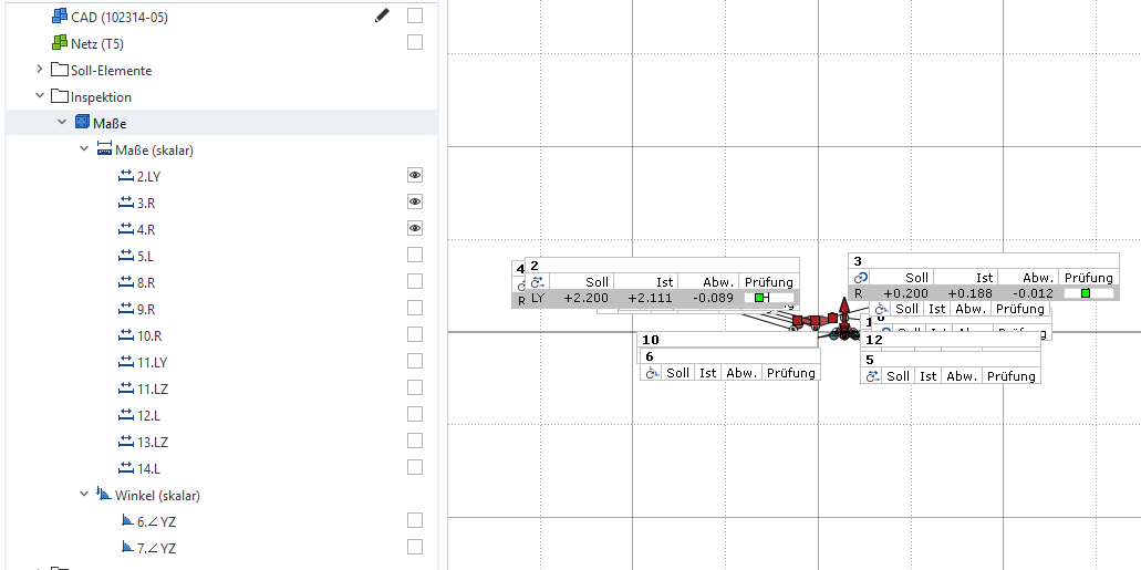

[Ma...] Posted November 19 Share Posted November 19 Is it 3D view or table? Anyway, you can select a row and click "i" to hide that evaluation. Link to comment Share on other sites More sharing options...
[Jo...] Posted November 20 Share Posted November 20 If you don`t select "show all..", only visible elements are shown. You should be able to "hide" stuff this way. Visible really means visible btw. not just "visble status turned on". 1 Link to comment Share on other sites More sharing options...
[JO...] Posted November 20 Author Share Posted November 20 Please sign in to view this quote. In the table on my report page, I would like to hide certain elements - such as Cylinder 3 & Cylinder 4 in this example - so that they do not show up on the report. Link to comment Share on other sites More sharing options...
[Jo...] Posted November 21 Share Posted November 21 (edited) Have you tried making everthing you want visible in the explorer and disabling "show everything" in the table view (see screenshot in my earlier post)? You should then zoom out so that everthing is really visible in the 3D-View. Edited November 21 Link to comment Share on other sites More sharing options...
[JO...] Posted November 26 Author Share Posted November 26 Please sign in to view this quote. Yes, that seems like a not-so-great workaround to solve an issue that should be quite easy to solve otherwise. Link to comment Share on other sites More sharing options...
