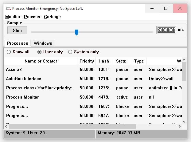

[Ca...] Posted November 21, 2025 Share Posted November 21, 2025 (edited) Don't you hate it when you saved a program after a whole day work and then to have it corrupt when you opened it. I opened other programs just fine and this program isn't even big. Edited November 21, 2025 Link to comment Share on other sites More sharing options...
[Ky...] Posted November 21, 2025 Share Posted November 21, 2025 I have not seen that error in years. Can I ask what version are you running, out of curiosity? Link to comment Share on other sites More sharing options...
[Ca...] Posted November 21, 2025 Author Share Posted November 21, 2025 (edited) Happened every once in a while. Calypso 2021 V7.2.2004(14.07.2023) Edited November 21, 2025 Link to comment Share on other sites More sharing options...
