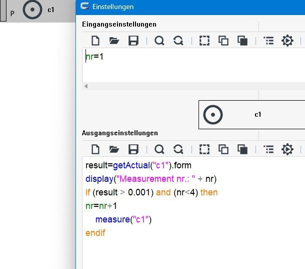

[Ri...] Posted November 23, 2025 Share Posted November 23, 2025 Hi everyone! I am trying to find out how to re-measure a feature according to a result, for instance, I've created a feature circle "c1" and characteristic "d1" and in the feature "c1" I placed on post-condition a code to check the error form like this: result=getActual("c1").form if result > 0.001 then activateFeature("c1") meausure() end if The idea is: if the result is bigger than 0,001 the measurement of the circle should be perform again, but it doesn't work. I will really apreciate if anyone has an idea how to do this. Thanks in advance// Ricardo Link to comment Share on other sites More sharing options...

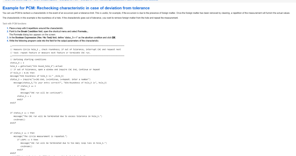

[Ch...] Posted November 24, 2025 Share Posted November 24, 2025 I would probably follow instructions from the PCM examples in the help manual : Link to comment Share on other sites More sharing options...
[Ch...] Posted November 24, 2025 Share Posted November 24, 2025 also the post adjacent to this at the time of this reply is asking the same question with nearly the same response. Link to comment Share on other sites More sharing options...
[Ri...] Posted November 25, 2025 Author Share Posted November 25, 2025 Please sign in to view this quote. I tried this code but it doesn't work because when I check for instance the form of a diameter and I choose option 3 to re-measure, it evaluates the diameter without measuring the circle again, because the loop is applied to the characteristic, not to the feature. Link to comment Share on other sites More sharing options...

[Mi...] Posted November 26, 2025 Share Posted November 26, 2025 Some brief idea would be with the following code in the pre- and post parameter settings of the feature "c1". 2 Link to comment Share on other sites More sharing options...
[Ri...] Posted November 26, 2025 Author Share Posted November 26, 2025 Thank you very much Michael! I will try like this Link to comment Share on other sites More sharing options...
