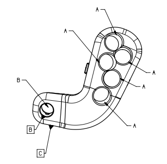

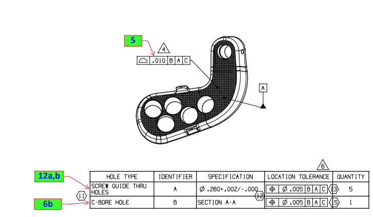

[Kr...] Posted November 24, 2025 Share Posted November 24, 2025 hello all, pls help to solve this dimension of 0.005"_A_B_C,Becoz,the customer given Datum A as complex surface of profile Thanks in advance. Link to comment Share on other sites More sharing options...
[Ch...] Posted November 24, 2025 Share Posted November 24, 2025 If -A- is a curved surface, then yes good chance Engineering was drunk (hahaha), but seriously if -A- is not flat as it appears, then you will have to review ASME Y14.5-2018 for establishing a non-uniform surface as a primary datum, think of a potato chip, etc. I'm not sure which version of CALYPSO can handle that, perhaps 2025. If A is a flat surface ,the profile to ABC seems reasonable here. Link to comment Share on other sites More sharing options...
[Ma...] Posted November 24, 2025 Share Posted November 24, 2025 I would use alignment with cylinder B as main, then use bestfit of freeform with only rotation and one translation along datum B axis. Not sure what datum C is for. Link to comment Share on other sites More sharing options...
[Kr...] Posted November 26, 2025 Author Share Posted November 26, 2025 Thanks for your kind reply. Datum-C- is angled surface. Link to comment Share on other sites More sharing options...
