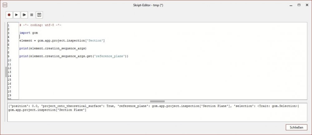

Im just looking how to in a python script, find the referenced element of an element. If I created a section that references plane Z. How can I get plane Z while referencing the section in the F2 menu?
Hello Shain,
with the instruction "creation_sequence_args" you get a python dictionary with information about the creation parameters of the element and with it the recerenced element.
In the attached picture you find an example for a section and its corresponding section plane.
