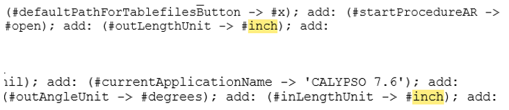

[JA...] Posted November 26, 2025 Share Posted November 26, 2025 Hello, I am having an issue where the software will swap between inch/mm once the program is complete. It seems to happen when running in auto run. I do have the program set to Inches but it will randomly switch to mm. It will not switch back until i open the program and save it again in Inches. Lately when I try to reopen the program, it will display a "Program not found" error. Terminate Calypso, log in and the program exists. I have a couple of programs that do this same thing on the same machine. Calypso 7.6 2023 Programs saved on network drive (This issue only happens on one of our machines, they all share the same autorun file without issues) Link to comment Share on other sites More sharing options...
[JA...] Posted November 26, 2025 Author Share Posted November 26, 2025 I did check the script. The program is hard set to be Inches. I am not sure what is convincing it to change. Link to comment Share on other sites More sharing options...
[Ka...] Posted November 26, 2025 Share Posted November 26, 2025 I checked our *.arn file against your tags "inLengthUnit"... We do not have any type of your tags inside our *.arn files but we run CALYPSO 7.4.24. Simply check what happens if you remove the tag inLentghUnit set it to (#inLengthUnit -> #mm) Link to comment Share on other sites More sharing options...

[JA...] Posted November 26, 2025 Author Share Posted November 26, 2025 I am using master and they are using a slightly restricted version of Autorun. What is odd is that we have 3 machines using the same autorun/settings. The other 2 machines are not experiencing these issues. Link to comment Share on other sites More sharing options...
