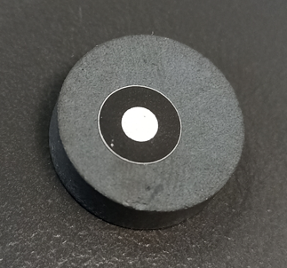

[Ma...] Posted November 26, 2025 Share Posted November 26, 2025 Hi, i am working on removal of magnets based on ref. points - i am using select inside sphere. Script is running ok, but i wanted to remove that from measurement instead from polygonized model -> i've solved. To block removing selection i wanted to use "gom.app.project.parts[0].actuals.selected_area" which is not working properly - it's saying 0.0 when is mesh polygonized and selection is on measurement. Bug part: But if nothing is selected, then whole Inspect is crashing. Using "try - exception" is not helping. Is there a command to get selected area globally? Not just mesh. Thanks Link to comment Share on other sites More sharing options...
[Ma...] Posted November 26, 2025 Author Share Posted November 26, 2025 Edit to topic: it fails in this case. ... How big is selected area Remove selected How big is selected area -> crash Is there a way how to see if its pre-mesh? I can not find any information if polygonization was done Link to comment Share on other sites More sharing options...

[Ma...] Posted November 28, 2025 Author Share Posted November 28, 2025 Please sign in to view this username. Hi, we are using magnets with sticked ref. point ( just to speedup measurement at low cost ). Those are not perfect made ( different thickness, not-centered ) and after scanning we are having problems with removing them. Sometimes there is face of a magnet, sometimes some residues of cylinder. We are using them on non critical places and they are just to keep tracking on our steel forms. Link to comment Share on other sites More sharing options...
